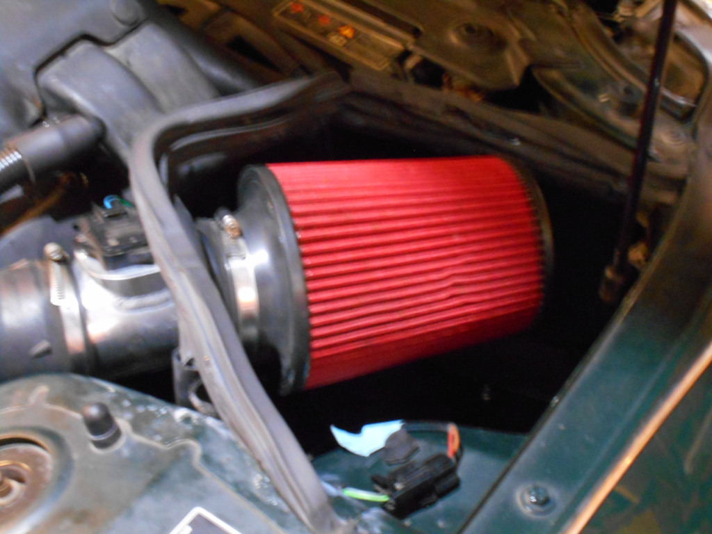

Yesterday night, I got around to installing my MINA Galleries cold air intake. When I was finished, I fired up the car and drove around listening to that glorious sound. I got to thinking though; If I could hear it, it wasn't sealed to the hood, or surrounding areas, and sucking in hot air.
I ended up cutting pieces of my collection of weather stripping, and stacking them on top of the round tube insulation, that came with the intake. I also cut the plastic plate behind the headlight in half, so it would butt up against the side wall, of the box. After that, I took thin one sided foam like you would use under a truck cap, to fill all the other openings.
It now is a true cold air intake, drawing it's air from behind the headlight, and through the hole in the inner fender.......I will post a couple of pictures, after I see the Chicago Bears lose today.
The end result is a cold air intake, that truly draws cold air, and no sporty sounds from under the hood. I AM going to purchase the neat chrome pipe Mina sells for the intake, and the rear muffler eliminator, with the four tips peaking out the back end......
I know I ruined a lot of sidewalk Jim Clark dreamers out there, but this is the way things are functionally supposed to be.......Be cool......Mike

Here are my pictures.....Not perfect, because I have a small tremor, but it is what it is.....We aren't animals, but we do drive them.....Be cool.....Mike
Attached Thumbnails If you can hear it.....It Ain't-dscn0983.jpg   If you can hear it.....It Ain't-dscn0985.jpg
