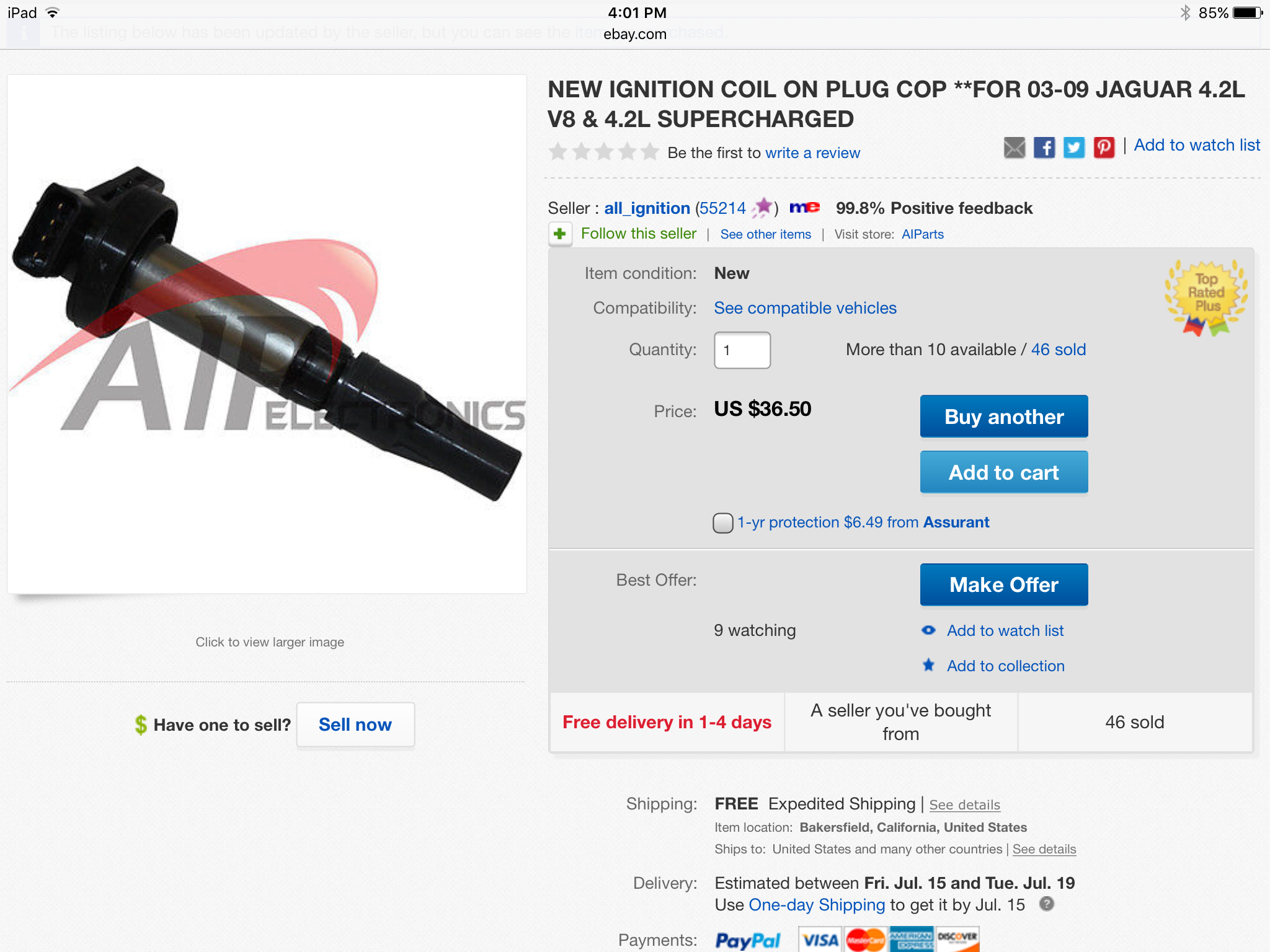

Old Sep 5, 2016 | 11:17 PM
Jandreu's Avatar
Posts: 2,173
Likes: 605
From: Goldsboro, NC
I've purchased two of these and the work great in my 03
