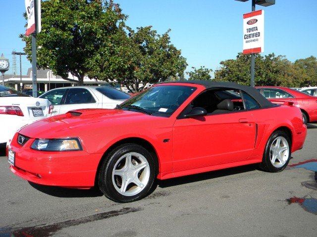

So I bout a better car but same colors and real power!
