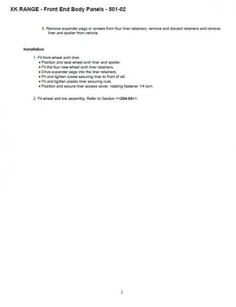

The Wheelarch Liner is secured to the Front Wing, Inner Valance and Front Bumper with three different types of fixing.
1. Plastic Hexagon Nut (removed with appropriate size socket)
2. Arrow head Clip (first pull the raised centre pin out until it locks)
3. Screw Rivet (first undo the centre cross head screw)
Fixings (2) and (3) are easily destroyed if not first released as described before removing them with a trim panel removal tool:
With care, all the fixings are re-useable many times.
Attached Thumbnails Instructions needed washer fluid bottle replacement-xk8-wheelarch-liner-1.jpg   Instructions needed washer fluid bottle replacement-xk8-wheelarch-liner-2.jpg
