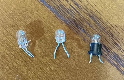

Radio:
LCD light: no base, 2.6mm diameter 5.5mm length
All other black base, 2,6mm diameter, 4mm length
Left to right LCD light, all other with base removed, all other with base in place
I am planing to find bulbs that are close to these dimensions and reuse old wedge type base which should make it fairly inexpensive.

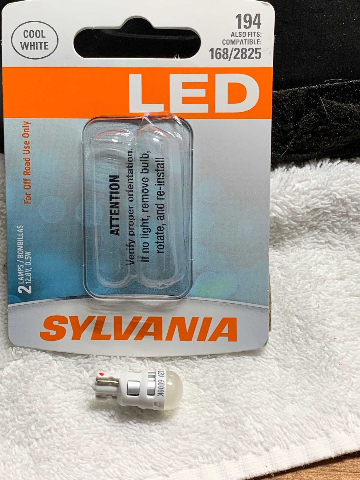

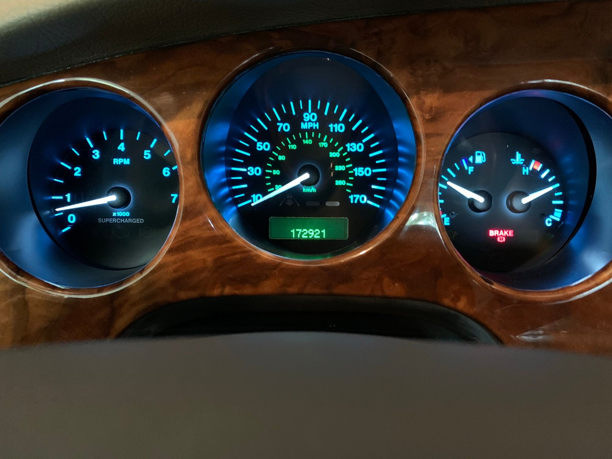

I used these:
they look stock tone to me, just brighter. Plus the polarity is marked, so no polarity testing or re-do’s needed. I got them from Amazon.

zray, I see from the pictures that you have 173,000 miles. Cool.
Old Apr 16, 2023 | 10:43 AM
zray's Avatar
Joined: Jan 2018
Posts: 3,724
Likes: 2,322
Thank you !
that photo was taken last year. I’m up to 181,830 as of last night. Hopefully this summer I can get over the 200,000 mark. The car has been the most reliable used car I’ve ever owned. I purchased it about 5.5 years ago. At that time it had 116,000 on it.

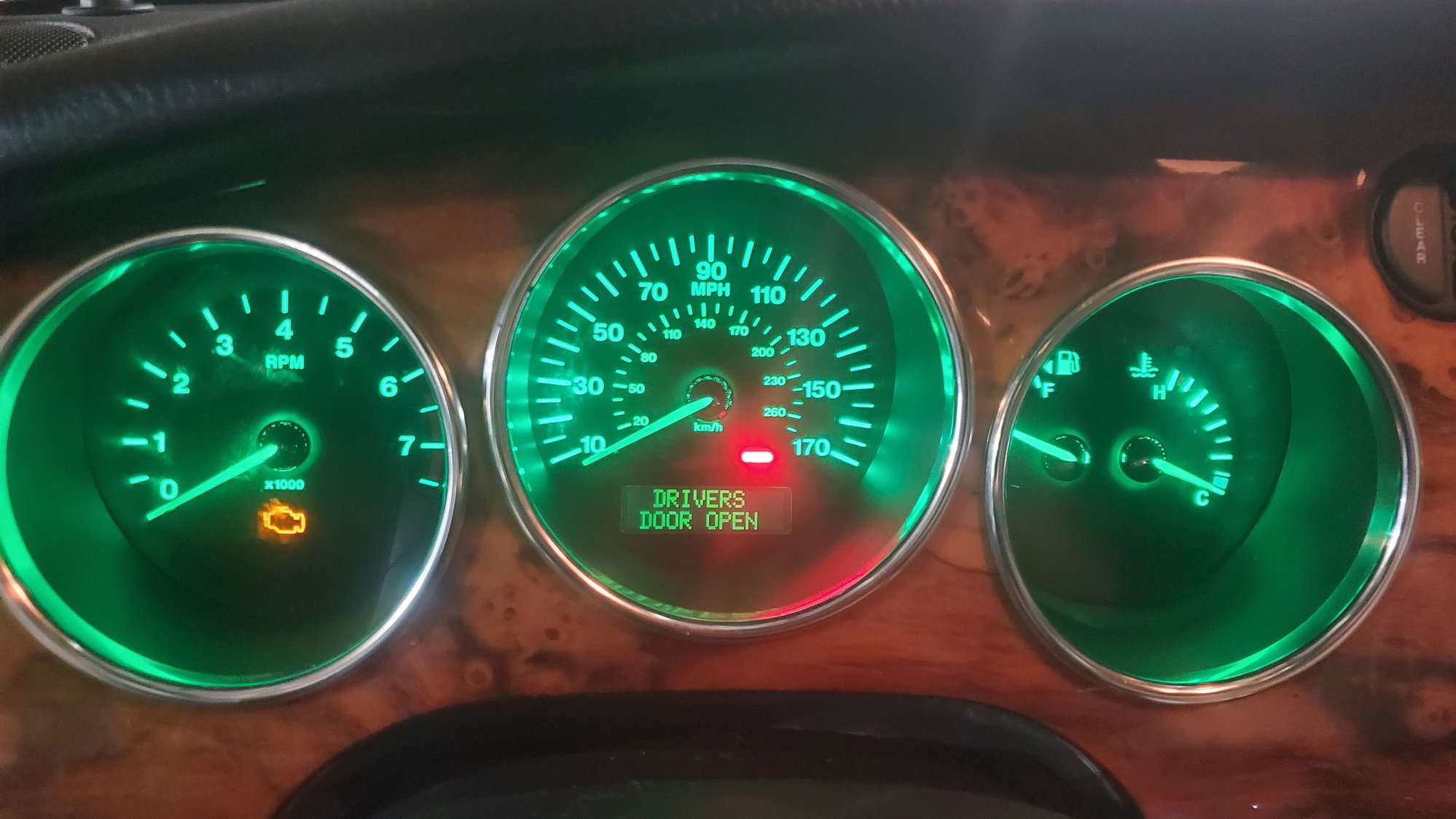

Here are mine with LAUSFIT green LEDs. Didnt do odometer as the washes out.
