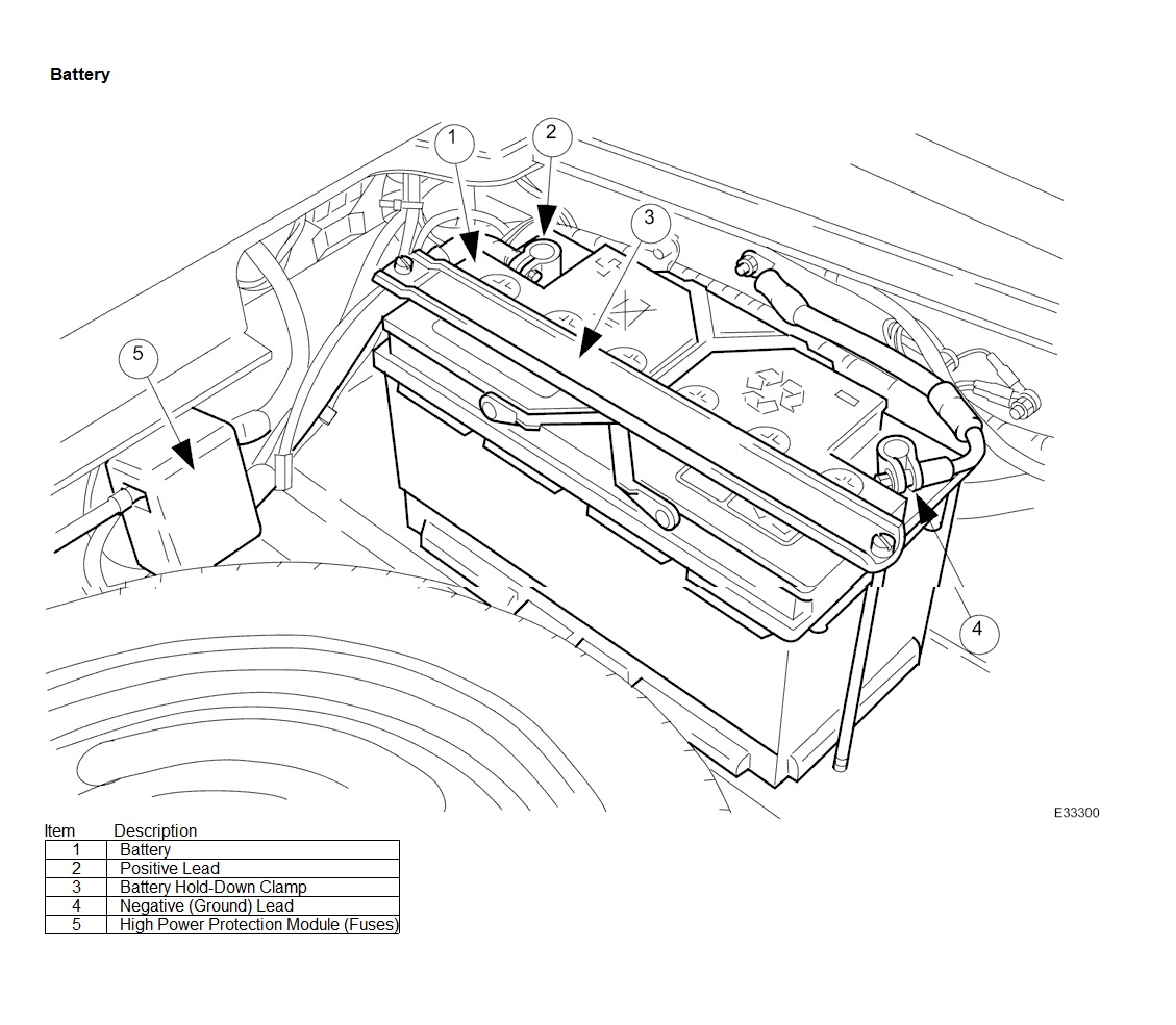

Tony,
Another one to check - High Power Protection Module (see item 5) connections.
The cable terminals are known to loosen and/or corrode leading to starting difficulties. The remainder of the electrics work but there's not sufficient juice to operate the starter.
