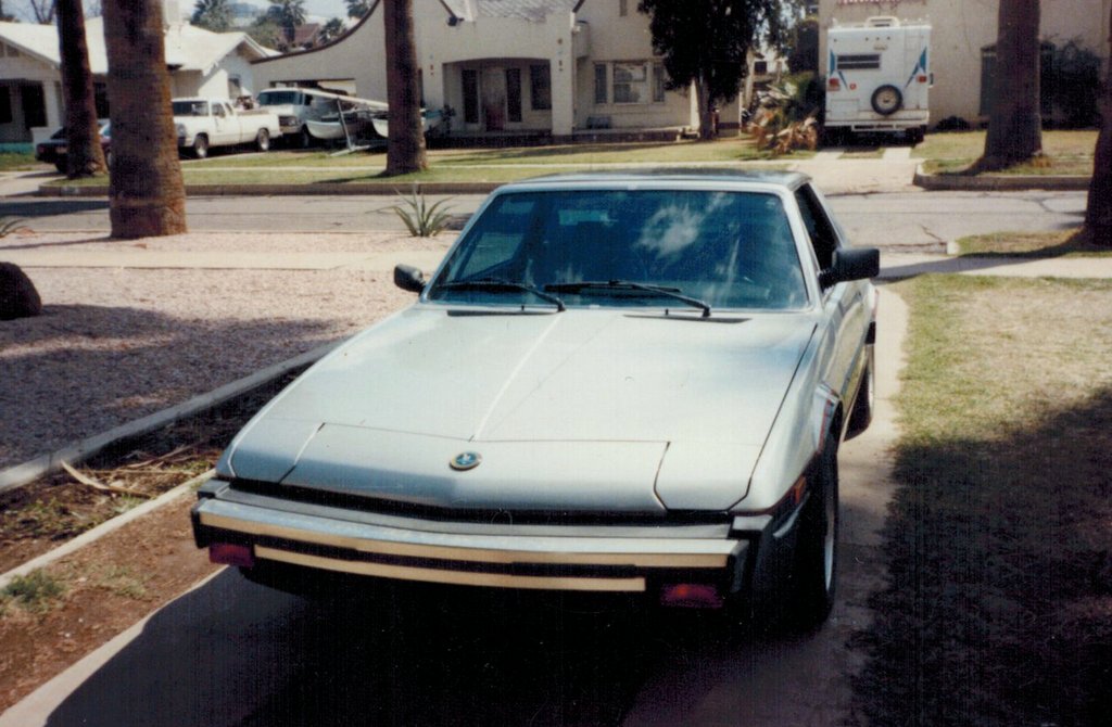

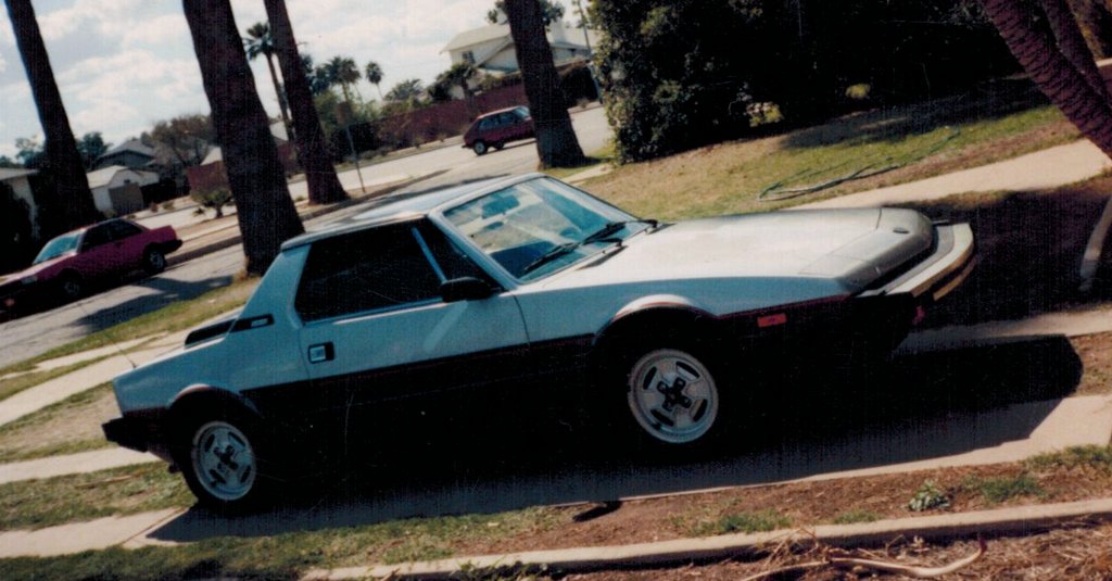

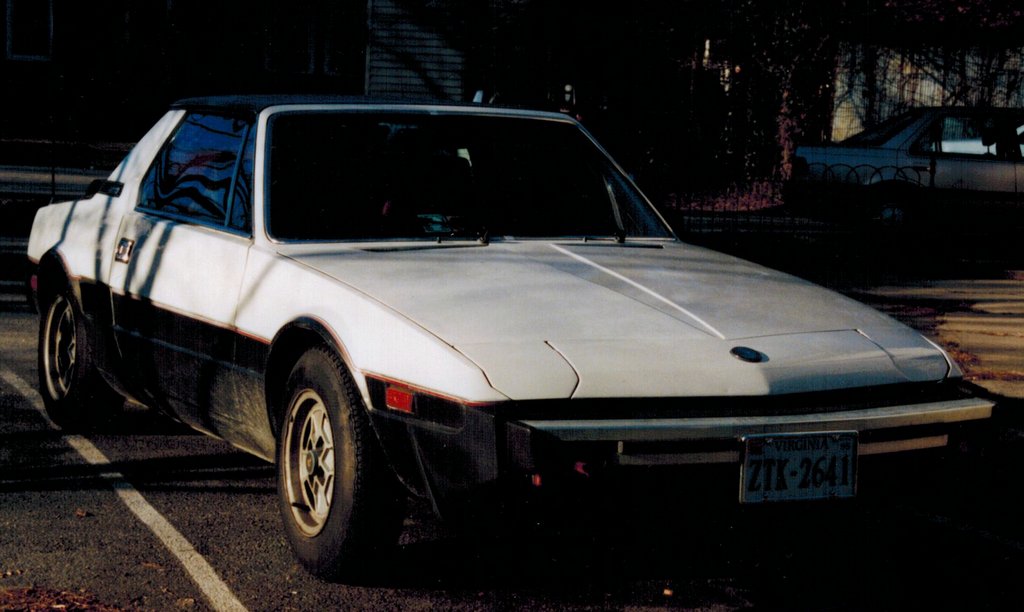

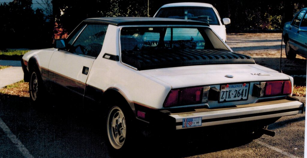

Originally Posted by RDMinor
I'd like to see some pictures of your X/19.
I've owned 2 of those damn things myself, an 83 and an '86...I will say this, I bought a brand new Miata in '91 and I wanted the X/19 back.
I had the Citroen version of your Merak, a '72 5 speed SM. Only car I ever owned that cost me on average $5k a year to keep on the road. and it only had 33k miles on it when I sold it. Was fun to drive though.
