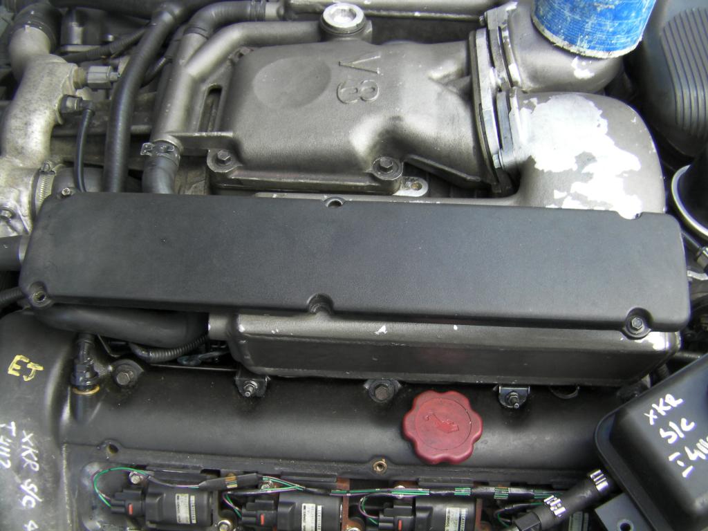

We had a day of heavy rain here about 10 days ago and the "restricted performance" fault reappeared. Rather than to-ing and fro-ing to the garage again, I decided to get out the tools and see what I could figure out for myself.
The first thing I noticed when I lifted the bonnet was water on each spark plug coil cover. As these are directly below the bonnet vents, it's easy to see how it got in. When I took the covers off, I found condensation on the underside of the covers, drips along the bottom edge of the coil recess and water in three of the spark plug holes.
I cleared the water out, greased all the electrical connections and applied grease to the steel surfaces of the coils to arrest the surface rust. I also found that one of the covers had been fitted the wrong way around and also previously damaged during removal. I put it back the right way round and used some sealant to keep out the water until a replacement arrives.
The long and the short of it is that, for the grand sum of zero money (and about two hours of my time) we now have a fully functioning XKR.
Moral of the story: even with our computer controlled, multi sensored, gizmo ridden, fabulous machines some faults are traditional in their cause, diagnosis and resolution. Don't just trust the computer to tell you what's up - take a look yourself.

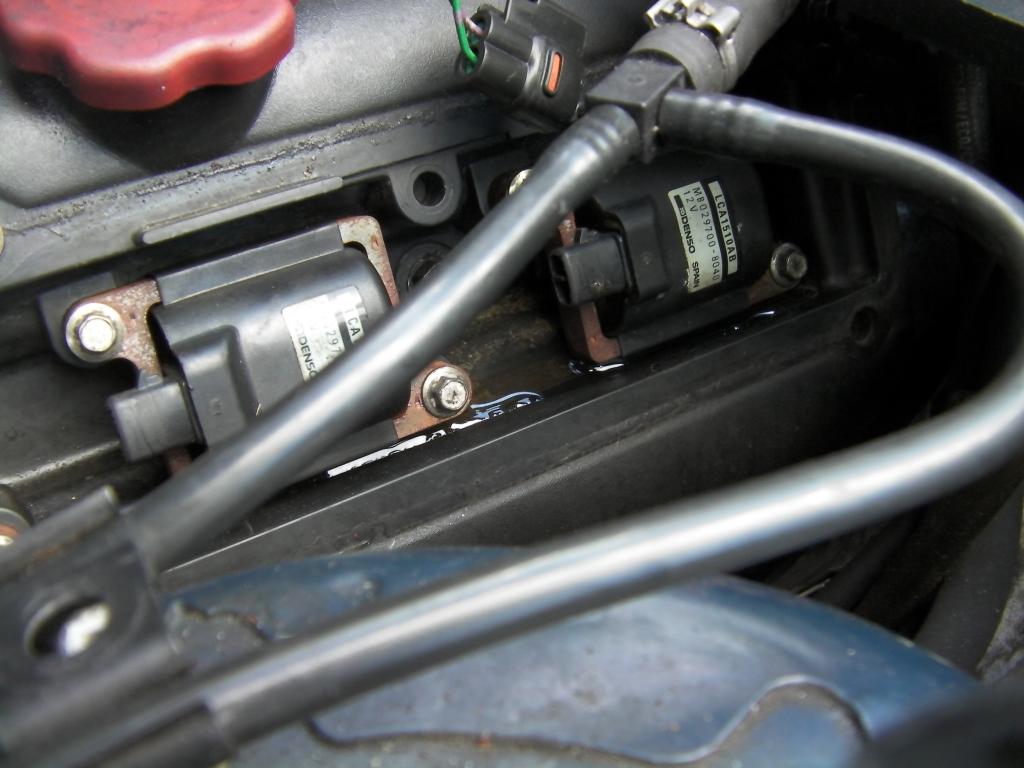

Driver's side cover off showing condensation:
Water in plug hole:
Passenger side with water along the bottom edge. There was water in the two bulkhead end holes right up to the top of the spark plugs:
Close up showing water sitting under the coils:
Damaged cover positioned as it was removed (ie: backwards, leaving a big gap at the left hand end for water ingress):
Water in plug hole:

Mine had the same problem with the condensation causing random misfire on 3 cylinders. The 2 middle screws were missing on the cover and it bowed upwards so moisture could get in and the misfires and codes only occurred on rainy days. My coils are also rusty from the moisture and someone had broken the holes out of the coil connectors so the plugs wouldn't latch in and then they put dabs of silicon on them to keep the plugs from falling out. I also put dialectic grease inside the plug boots with a q-tip to keep moisture and/or oil from traveling up the plug. I replaced the missing screws. I haven't had a single misfire code since.
