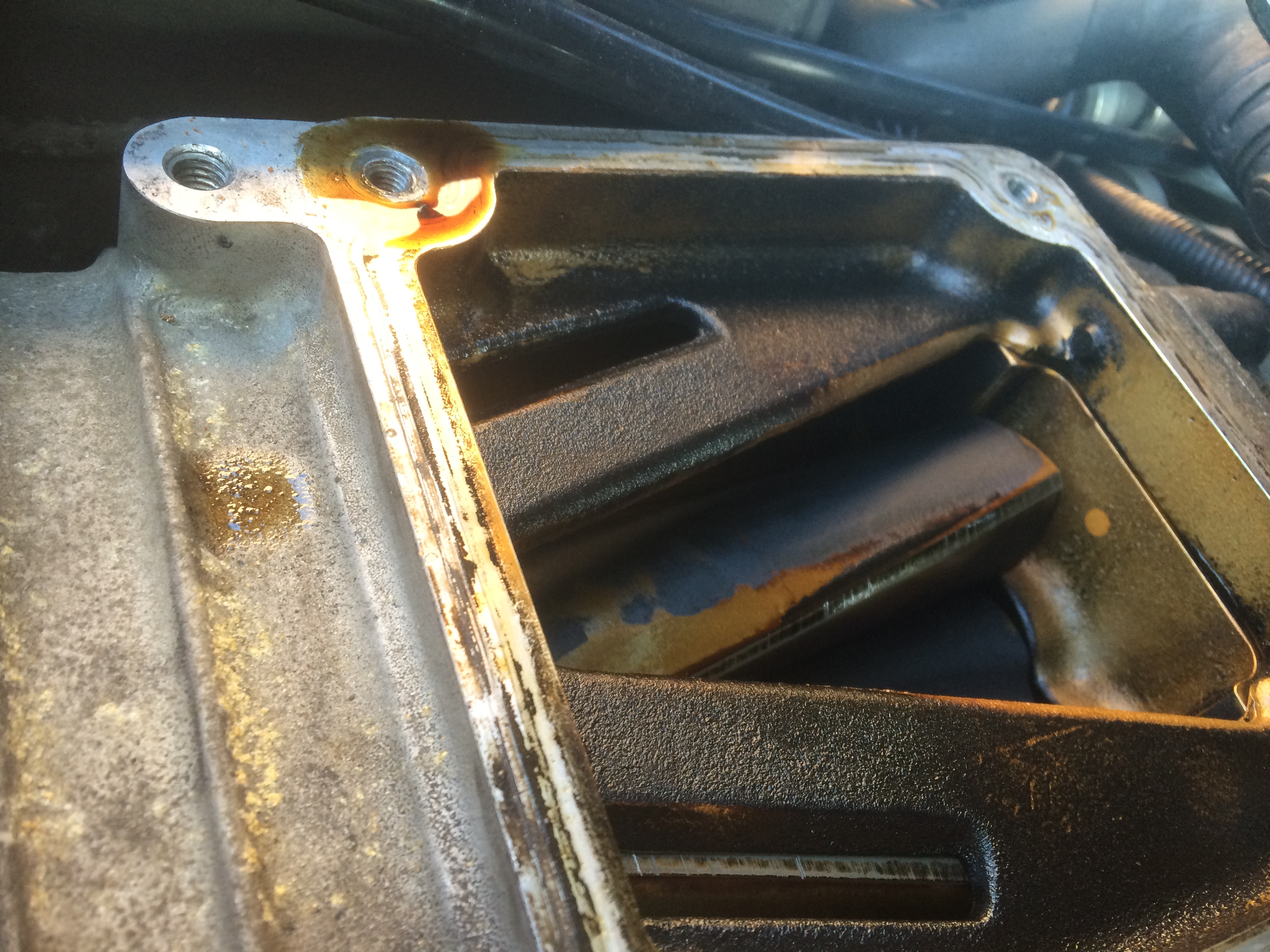

Starting the car I can see that the supercharger bypass valve is drawn open by the engines vacuum, disconnecting the vacuum line to the bypass valve to keep it closed (and plugging the line) gives no difference in boost/vacuum readings. Removing the supercharger to charge cooler casing and starting the car confirms drive to the supercharger scrolls.
When I originally bought the car, there was a small LPG leak so I replaced all of the LPG hosing, this involved removal of the Supercharger and charge coolers to access the LPG injectors underneath, all gaskets were faced with Silcoset prior to fitting and there was no obvious difference in performance before and after action so i don't believe i'm loosing the superchargers output through boost leaks alone.
Supercharger belt configuration is correct so its being driven positively, belt tension is good.
So, possible causes?
I'm assuming the supercharger bypass valve is positively closed by the spring action of the actuator and then the building of positive charge of the supercharger. Is this a common failure point?
Is the supercharger prone to complete loss of boost generation through lobe wear etc? The supercharger is not overly noisy, it has the occasional knock at idle but doesn't sound like a bag of bricks, although the rotors show wear to the leasing edge of the lobes and carbon deposits, theres no significant/catastrophic damage from FOD ingestion etc.

Bypass valves can leak, but there can also be leaks in the piping to it. At idle (warm engine) you should have more like 16" (give or take) of vacuum (assuming 30 is absolute vacuum), so if you have 5 now, there is definitely a leak.
Best guess for the boost side is that the vacuum valve isn't working, so it stays open.
The P1647 pending on the build year it could ether be a fuel pump issue or a O2 issue. Here is some more info:
https://www.jaguarforums.com/forum/x...nfusion-57005/
I would fix the P1647 and the vacuum part (so check bypass valve unit/piping to find the leak), and then check the boost side again.
