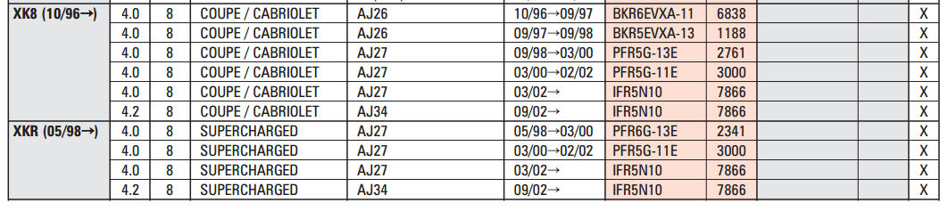

According to my NGK catalogue they only recommend the platinum for your year PFR5G-11E (NGK stock number 3000)
