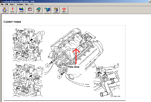

This is the hose I was talking about.

I have pinpointed the smell to directly below the throttle body. I actually wiped underneath it and did get a few pink small stains on the paper. Not enough to even look like a drip. But the smell is really strong so there is a leak somewhere there. Would it do me any good to remove the air intake pipe or do I need to remove the entire throtle body, which I'm not really comfortable doing. My mechanic says he will but I'd REALLY like to take it in with a specific location.

Something to look at is the plastic three-way connector that one end of the bottom hose from the expansion tank goes to down where the large hose comes out from under the intake below the throttle body. I just replaced it in my '01 XKR as it was cracked and leaking. The part number is JA NNE3944BA. That might be the problem.
