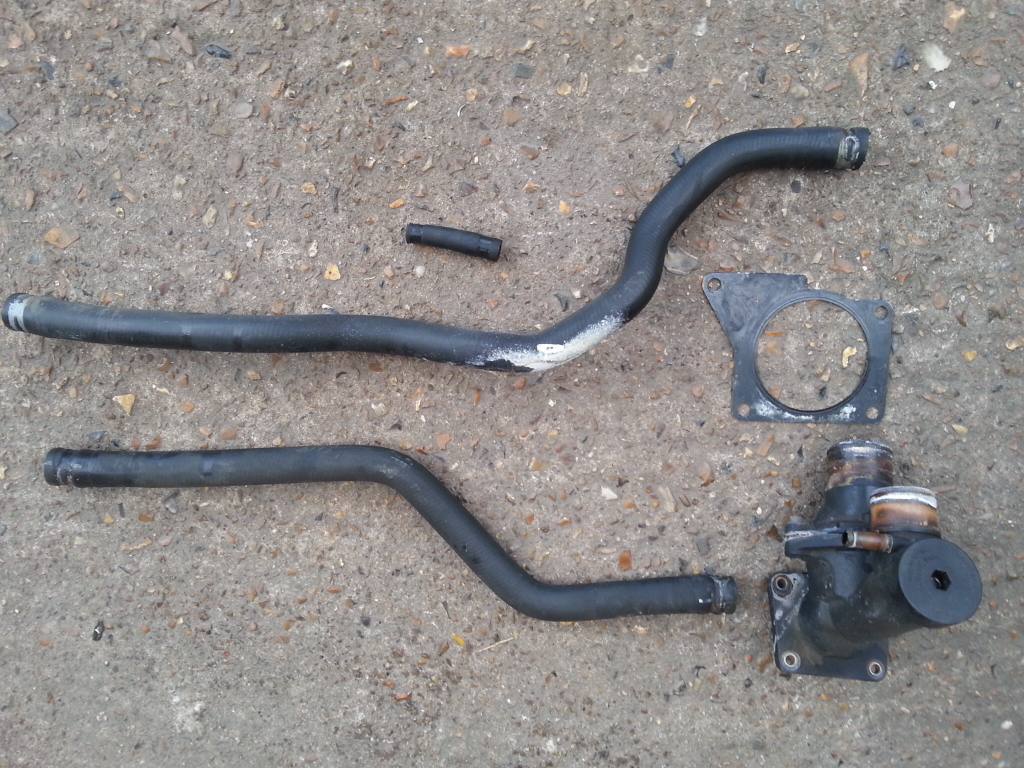

I did my valley pipes today, took about 3 hours....... Easy job.....
You can see from the pic where my leak was coming from the block
Attached Thumbnails It's back. That coolant smell!! This time, low coolant light.-0ecf58afd1f5217cb2ee3b5639233469_zpse10eb488.jpg

Depends how mad you go, I changed to the aluminium tower, had a bit of a clean up, then put it all back together
Attached Thumbnails It's back. That coolant smell!! This time, low coolant light.-e7fc5e38dc1f825bd0d4803a2a94643b_zpsf1b51504.jpg

You have gone a bit OTT on the parts but that is your choice, no need to drain the whole system just the top half, no need to remove the throttle elbow but you could replace the gasket whilst it is off, very easy to get to when the manifold us out....
All I replaced was the TB gasket, the obvious hoses and the thermostat tower, I had go also change the small hose going to the tower as it would not seal under the pressure check

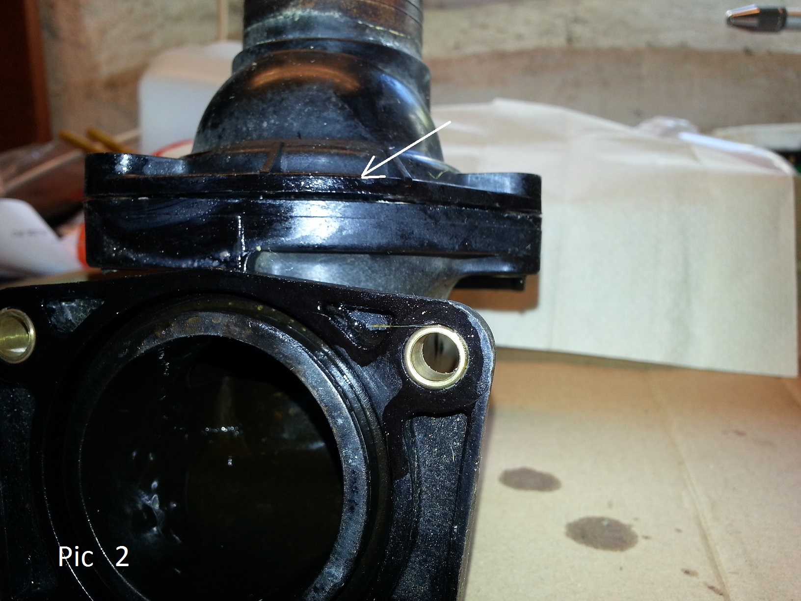

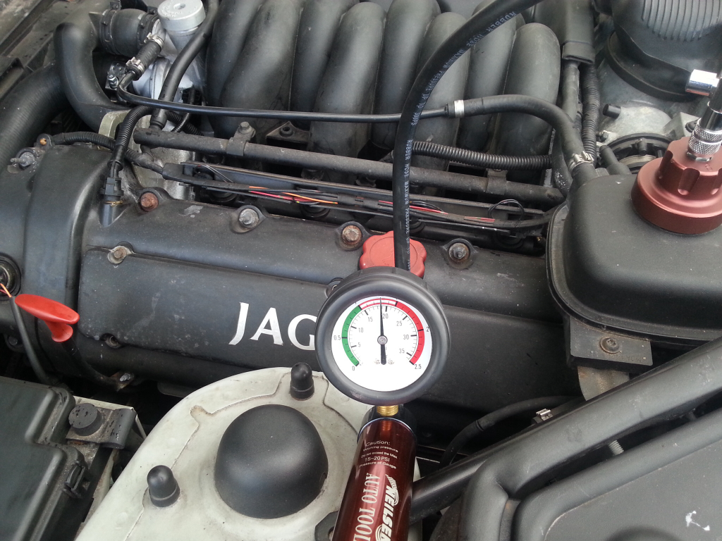

Old Jan 7, 2014 | 06:37 AM
  #58
philhef's Avatar
Posts: 2,916
Likes: 547
From: North Carolina
Well. pressure test shows nothing so it's time to remove the throttle body and manifold and check there. My gut says it's the valley hoses as others have suggested. probably a small weep that doesn't show.
