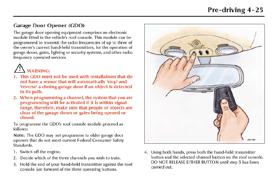

Hello everyone, Above the mirror is a light consol with interior light switches for left & right lights. There is also a chrome grill which I believe is a speaker? However there are also 3 small round black buttons/switches between both the interior lights. Is there anyone who can tell me what theyre for. Unfortunatley I dont have an instruction manual for the car. Thanks in advance. Mike

The grill covers a sensor and the three buttons are for the optional Garage Door Opener:

Thanks again...................You guys are great!!!
