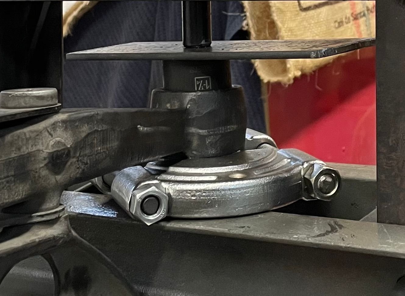

To remove the bushing, I used a bearing separator and a 1 ¼ socket as illustrated pressing out the old bushing. Photo 2, Bearing Separator Work diligently to separate the arm from the bushing ledge tightening the separator to get a good surface to press. Once the bearing separator has a good grip on the Control Arm the bearing should press out. I used a 12-ton press. I will admit I trashed the first bushing trying to figure out the better way to remove it with the bearing separator. Once they were removed, I cleaned up the control arm openings with fine (1000) emery paper.

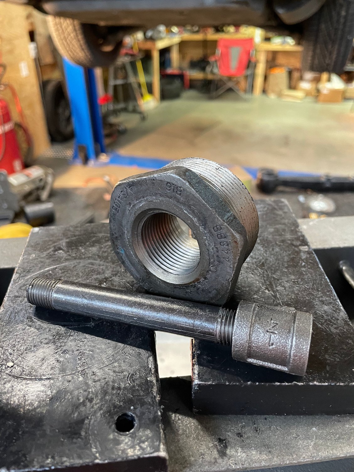

Photo 3, The plumbing fittings

Photo 4, Pressing the Bushing into the Control Arm.
The next item was to press in the frozen bushing into the newly warmed control arm. What is needed is a flat surface wide and strong enough to withstand the 12-ton pressure. The special tool I came up with is a plumbing coupler fitting with a wide surface that would completely cover the surface and an inset to keep it centered. Photo 3, The plumbing fittings. Although subsequently the center pipe was not needed. My concern was the rubber. Would it cut away or separate from the housing and trash the part. Come to find out it could withstand the pressure and bounced right back to its original shape. Photo 4, Pressing the Bushing into the Control Arm.
