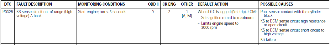

Highly unlikely, but a failing battery can cause spurious codes to be thrown. Try the simple checks first:- getting at the knock sensors on the R is not a trivial job.
DTC summary for P0328:
Good luck!
