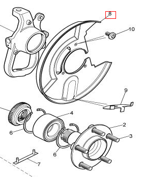

I once had the same symptoms on my 97. What I found was that disc brake shield had come loose at the bottom.
It is normally held on by a small clip (see #9 in the attached photo). If the clip comes loose it can cause the shield to scrape against rotor at certain turning angles.
A revision in later brake shields eliminated the lower clip & the shield is held more securely at the bottom by attaching to the lower ball joint bolt. I changed to the later shields when I rebuilt my whole front suspension.
Of course there are a whole lot of other things that may be causing the noise.
