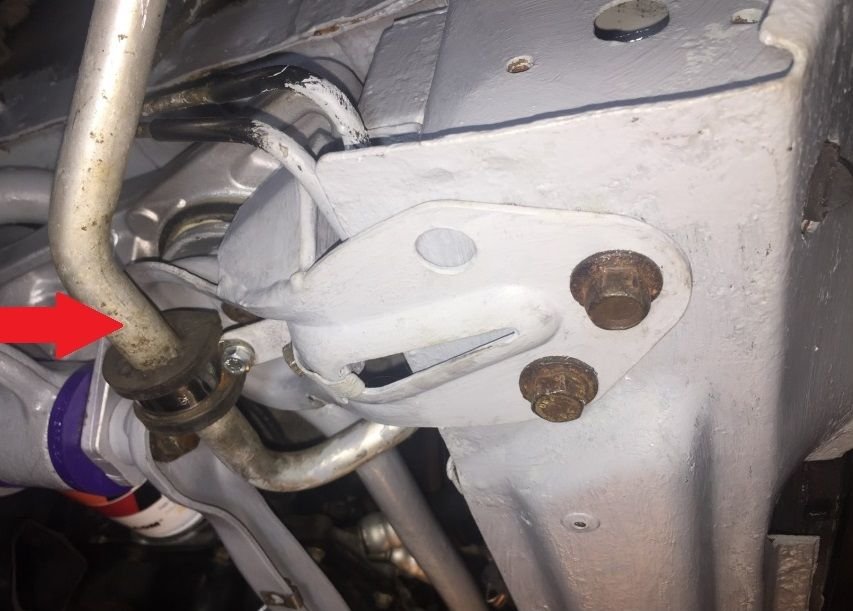

+1 As michaelh says, the clearance will be very limited. I only just managed the job during a major strip-down and when the front cross-member was off !
I thought the piping (arrowed) which is routed under both left and right cross-member brackets would restrict the amount you lift the heat exchanger pack, but I'm wrong, these are Oil cooler pipes - which are not attached to the engine Rad and A/C Condenser!!

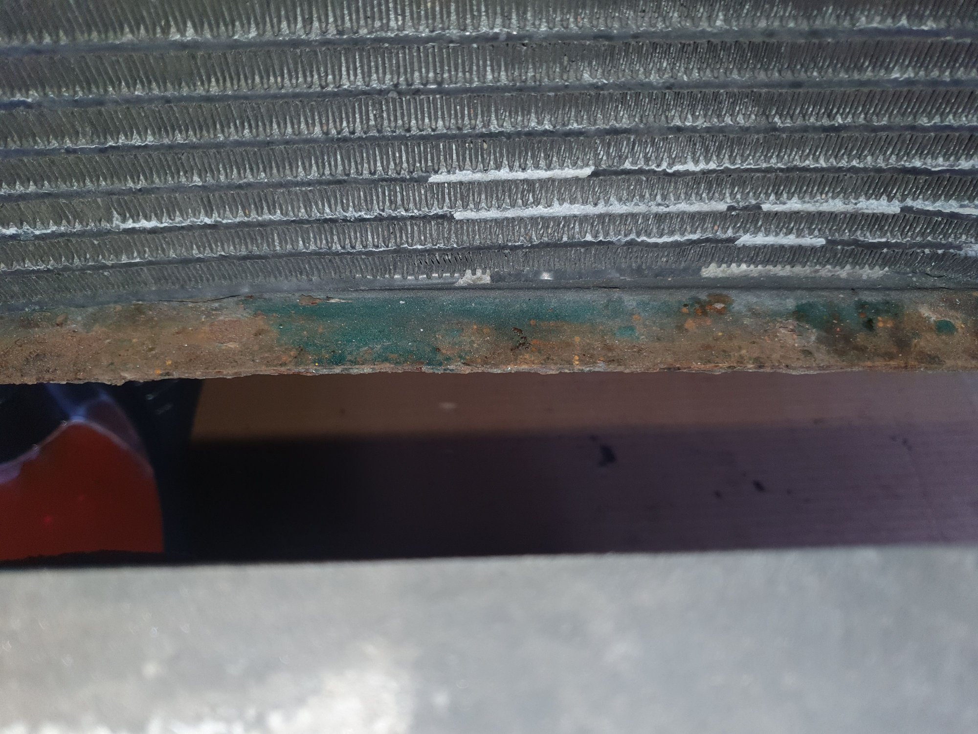

I'm going to try and get the fans out in the morning so I can investigate a bit. Maybe once it is all loose it might move back slightly. I only need a bit more edge to work with.
as you can see the rust is only on the edge so not major but I want to be able to clean it all off properly and repaint Just really don't want to remove the whole lot.
