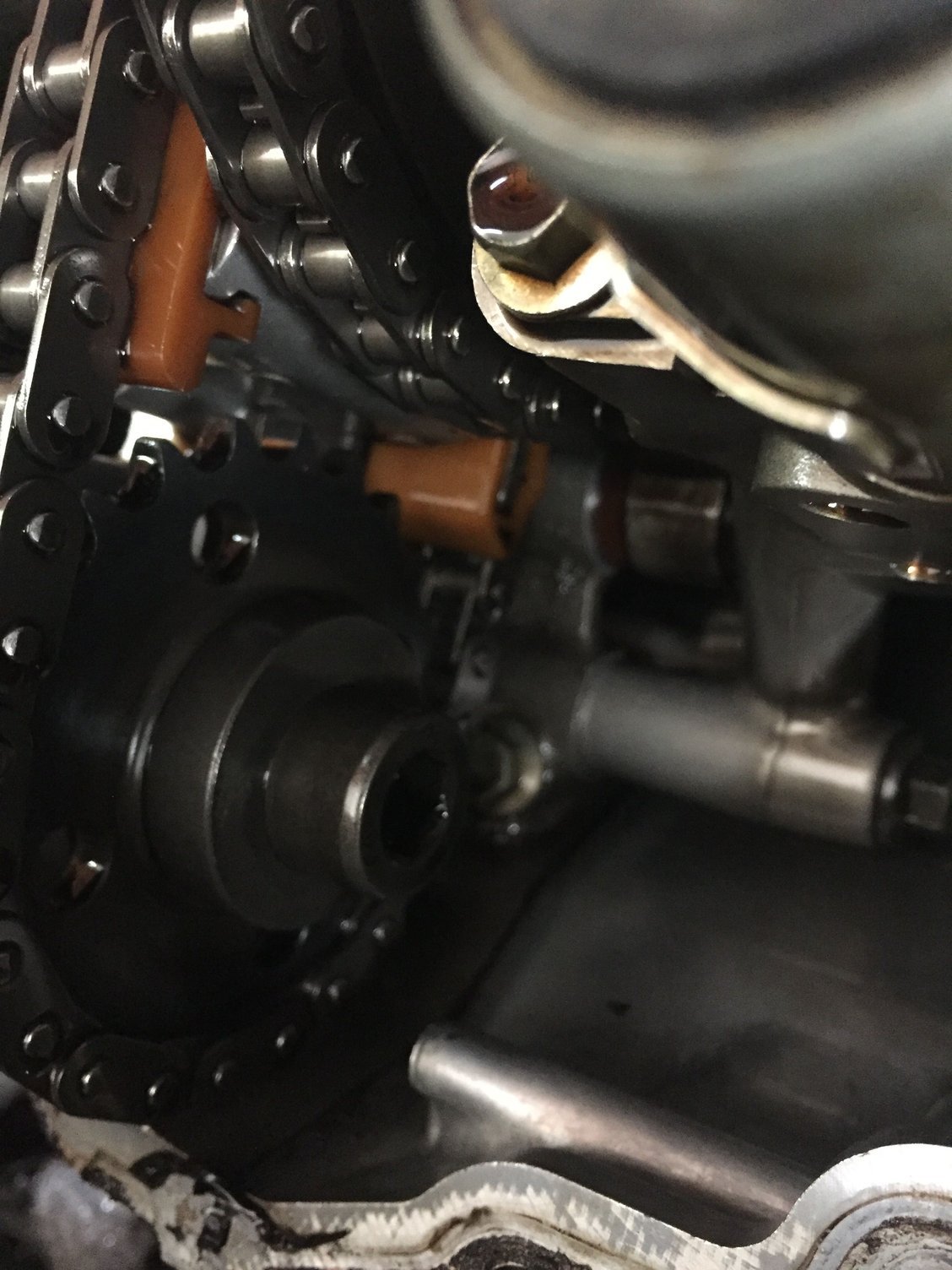

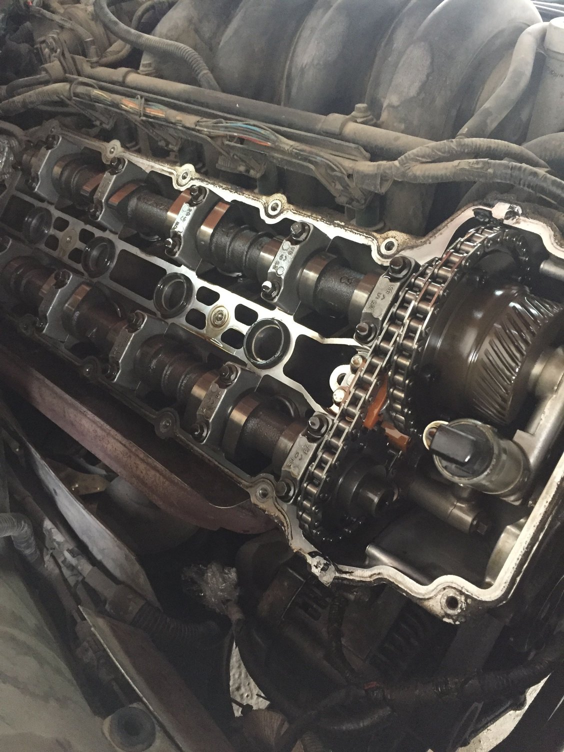

As for your 10-15 Sec engine tap upon start up, I strongly suggest you check out the secondary tensioners esp. As you suspect there’s no service history, the problem is whether the modern metal bodied tensioner units have been installed. If they’re the source of the noise, it’s a potential engine killer! Easy DIY to have a look!
view with cam cover off on AJ-27 NA engine
View of metal bodied tensioner sitting under the chain
If you can’t DIY this, any professional garage should easily be able to check.
