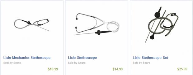

With the noise you are addressing you should be able to use a stethoscope to identify the location of this tapping. You could put the car in drive, foot on the brake and bring the engine up gradually and see if the noise continues. If it is a piston wristpin or a bearing it will get louder under stress. I had a 93xj-s 4.0 and I recall a conversation with Jag mechanic about a shim that is installed at the valve spring to prevent a valve tap but was unable to recall the exact reason behind the comment. See about getting a stethoscope.
Old Nov 15, 2009 | 10:46 AM
Gus's Avatar
Gus
Joined: Jul 2008
Posts: 11,356
Likes: 2,236
From: Berlin Md.
This is what you need.

I think that Pep Boys sells these as well and I might just invest in one the next time I am shopping for auto paraphernalia.
