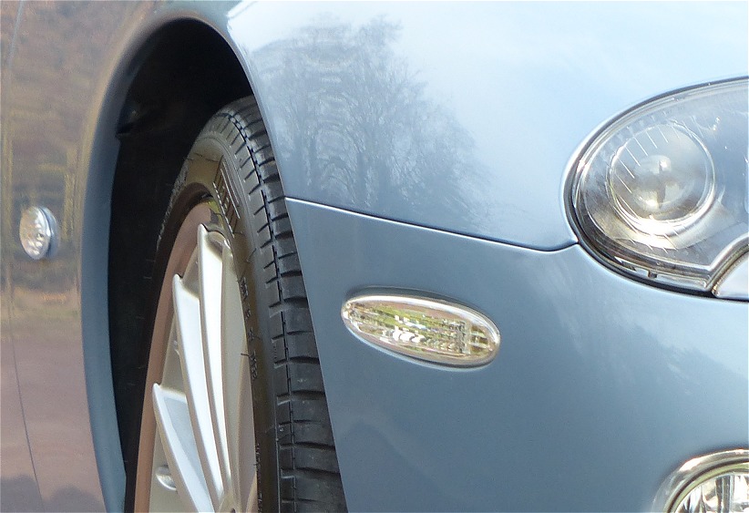

Here in Europe, the small repeaters in the front wings are for the indicators, the large ones in the front and rear bumpers are non-functional side lights or passive reflectors. There are no leapers on any of them.
The small repeaters are available in orange, translucent white or crystal clear (which I have). The latter two require an orange bulb, but these can be sourced with a chrome effect to avoid the egg-yolk look, otherwise you can also spray the orange bulb lightly with some silver paint.

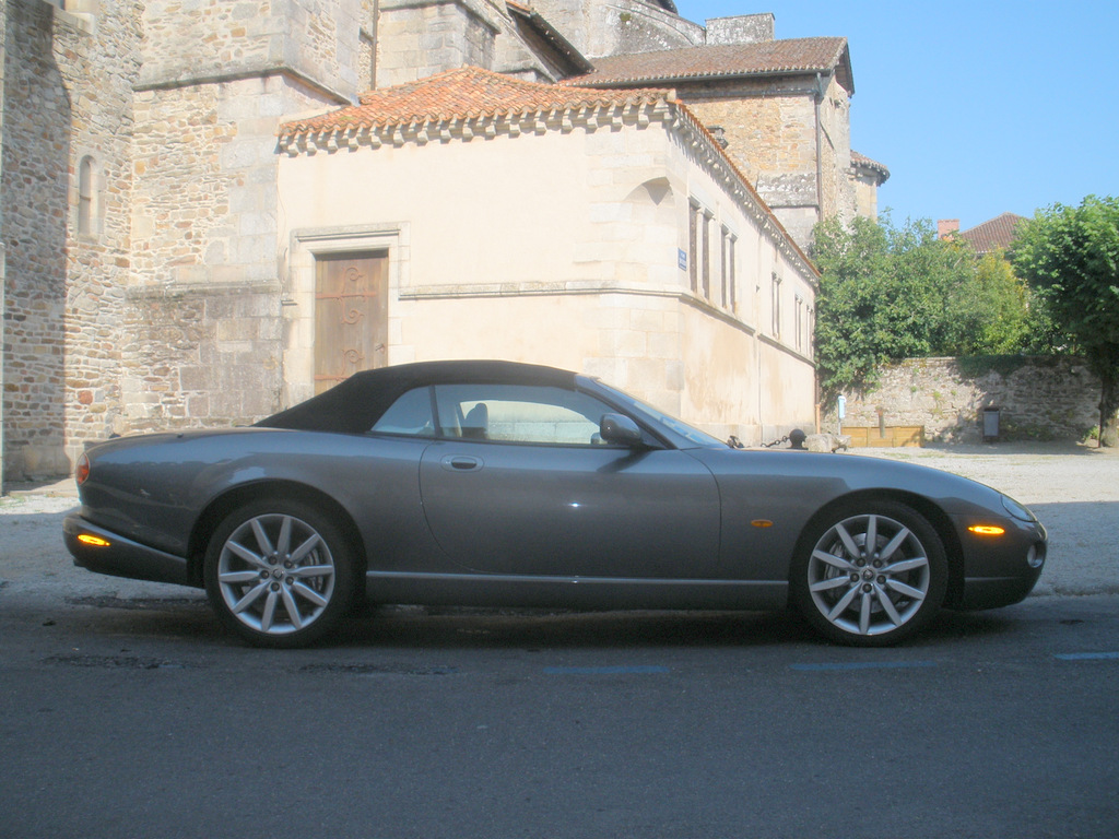

Here's an interesting pic
The lights are off - the fill-in flash caught the reflectors Frog mentions.
They've got wires running to them but are just reflectors.
Side running lights are illegal here - we had one member who failed his contrôle technique because of them but was able to remove them with Photoshop to pass !

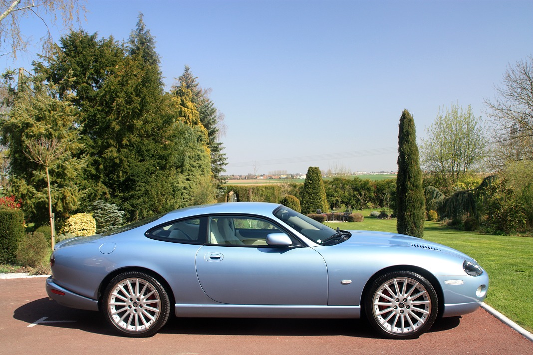

Old Mar 10, 2013 | 05:00 AM
Steve,
I can see there's a slight rise on the road which may affect the way your car sits but the front suspension looks very low.
The sill line on mine is parallel to the ground.
The reflectors still pick up the flash bounce.

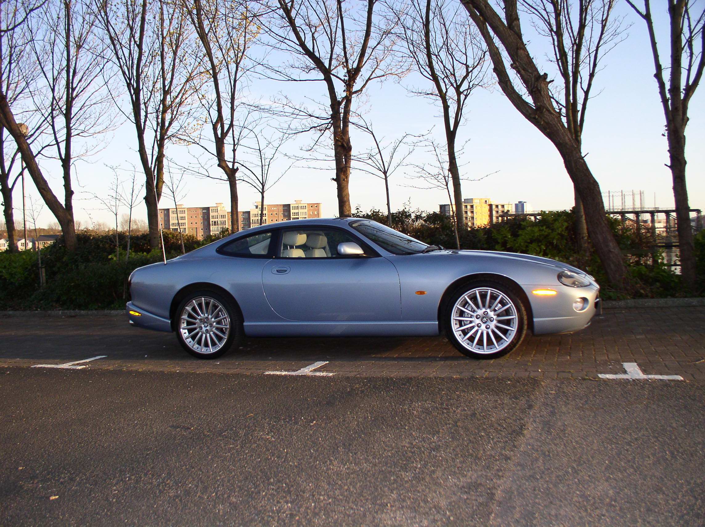

^If you look at Steve's sigpic, you can see his front is relatively low. If anything, I think your car looks slightly higher than average, Graham, at least in the photo above...
(picture inverted for easy comparison)
