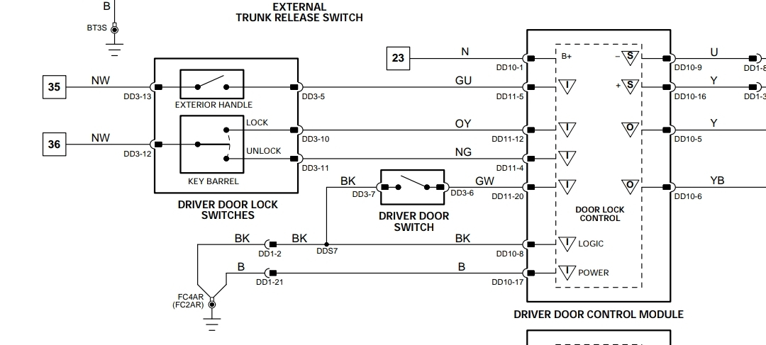

I am trying to intercept the lock wire, from inside the car, that goes to the central locking unit.
Does anyone know the position in the car and the colour.
I have been at it for three days now trying to fit an Easy Guard walk away locking mechanism.
Thanks in advance
Stus

Unfortunately it doesn't work like that - the door locks are controlled by the door control modules and the body processor module and they communicate on the SCP bus, so there isn't a simple one wire control that locks them.
You would probably have to look at the driver's door lock switches where it connects to the driver's door control module and connect to the "lock" switch on the key barrel, so the car thinks you have momentarily turned the key to the lock position.
You need the electrical guide for your car. Download it from Gus's site:-
http://jagrepair.com/

Thanks for the quick response Any chance you would know where inside the car and what colour the wires might be to activate the lock switches.
Thank you in advance.for any info
Cheers , Stus

You need to download the electrical guide for your car that will give the wire colours. The modules are in the drivers' door.
Here is the diagram for my car, which might be different to yours:-
I would use a relay to bridge the lock switch. If you don't know what you are doing, don't attempt this. If you do know what you are doing, take your time to understand the wiring diagram - all the information you need is in the electrical guide for your car.
Good luck!

Trying to connect to the lock switch on the key barrel. I have the doors locking only for a moment, then they unlock again seconds later. You mentioned the key barrel lock switch earlier . There is only a black and blue wire on this barrell the others are . Live, ground, starter, and fuel pump I think.
I have the diagram for my car now, thanks. XKR YEAR 2000.
MANY THANKS
