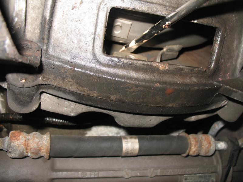

Unfortunately i couldn't see past the torque converter housing through the transmission aperture ( piccy 1 ) to wedge anything in the driveshaft, and i don't have a prybar, so i had to "improvise".

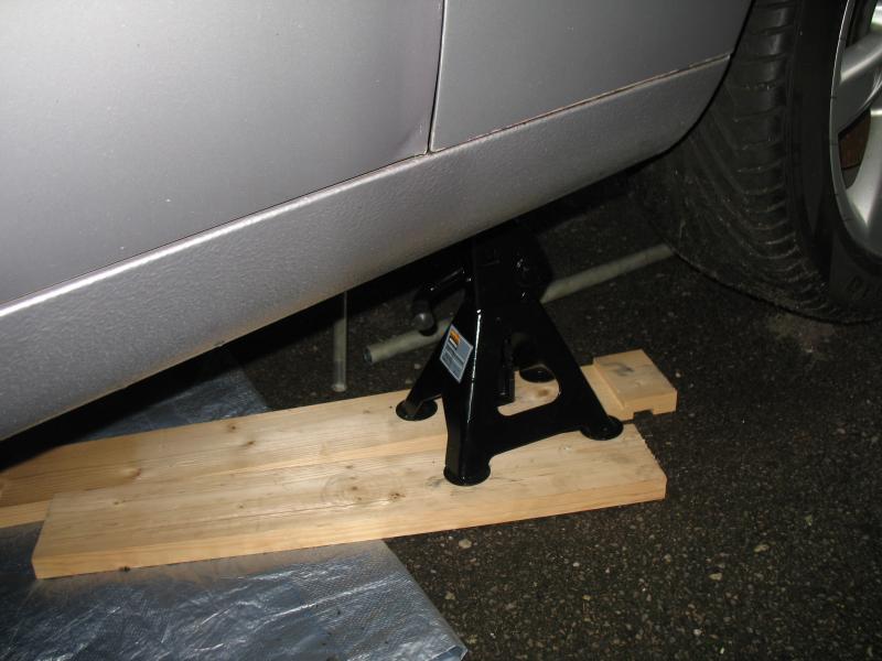

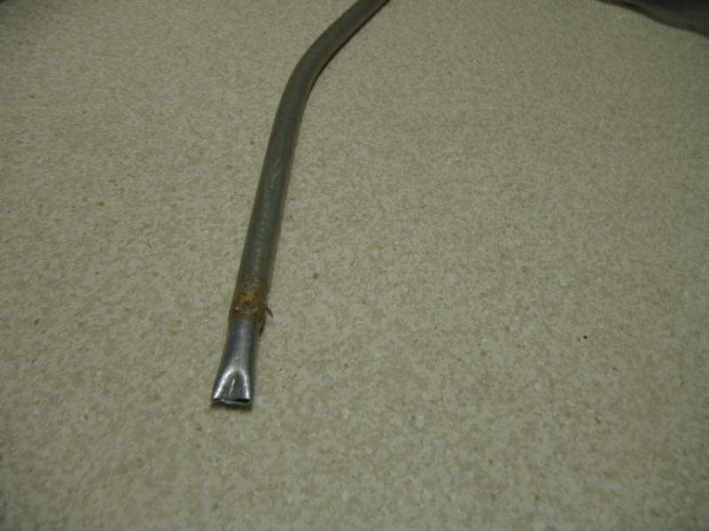

I found a hollow aluminium pole of about the right length for what i had in mind ( using a piece of wood under an axle stand as a brace ) and flattened one end of it to an oval shape to wedge in the the torque converter boss.
The aluminium pole wasn't quite up to the job, but it did get me to over 350NM before it gave up and bent.

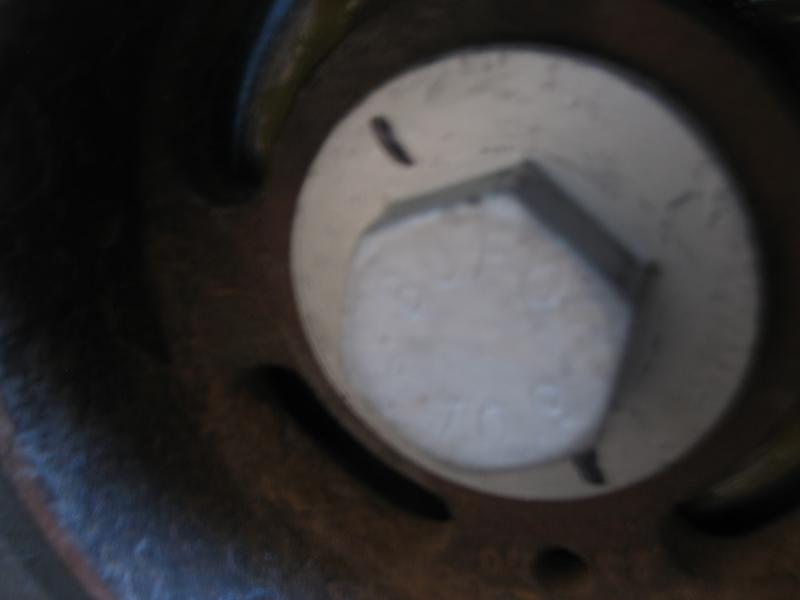

Also. i marked the bolt at 80NM and from pic 3, the turn from there was around 180 deg.
The top mark is where the bottom mark was at 80NM

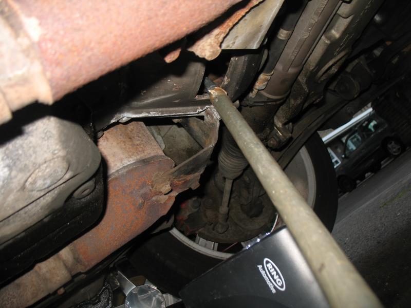

Pictures 4 & 5 just show what i was up to, and whereabouts, for anyone thinking of using the torque converter to lock the crank.
