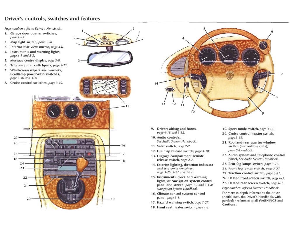

5. sit in the car with the handbook and check every switch works. There's a lot of them:
Attachment 59342
Commonest problems are with seat adjustments not working (motorised headrest drives often fail), powerfold mirrors, AC/Heater either not blowing adequately hot or cold.
