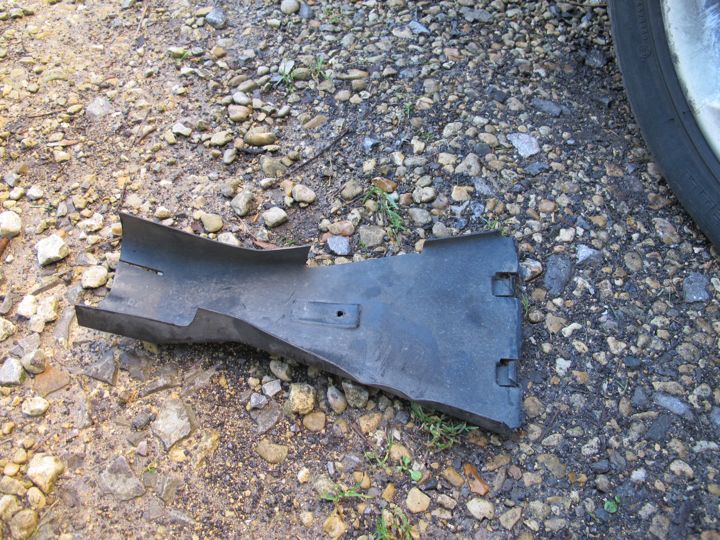

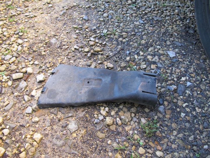

Heard a scraping noise from under the engine bay while out driving earlier this week. Assumed it was a plastic bag or twig and left it to the week-end to see if it was still there.

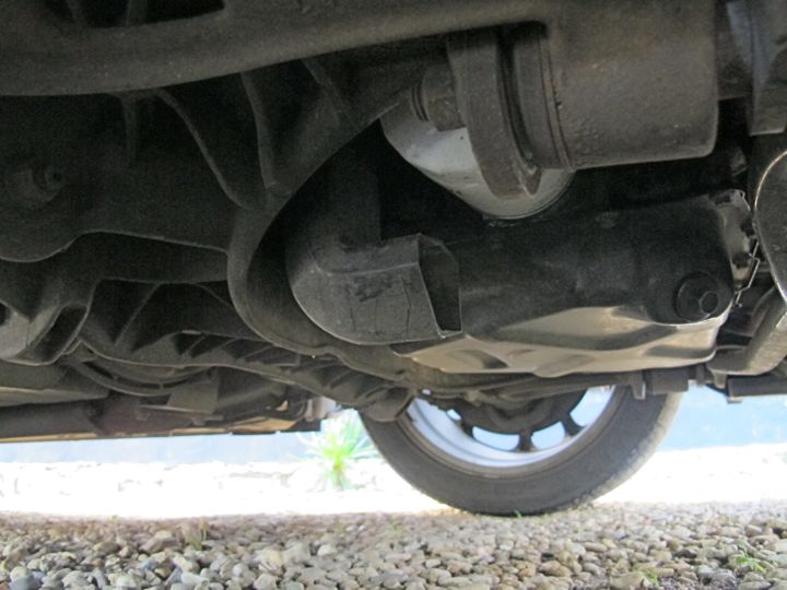

When I had a look under the engine, I found this dangling from the underside of the engine:
The u-shaped end was wrapped around the hexagonal hole in the picture below, while the flat end was scraping along the floor:
Any ideas what the plastic shroud is? Does it belong on the XKR? If so, is it important and does it need to be re-fitted? Or can I just ignore it? What does the plastic hexagonal duct do?

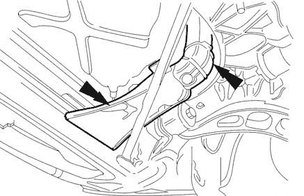

Hi.
Part of generator air duct.

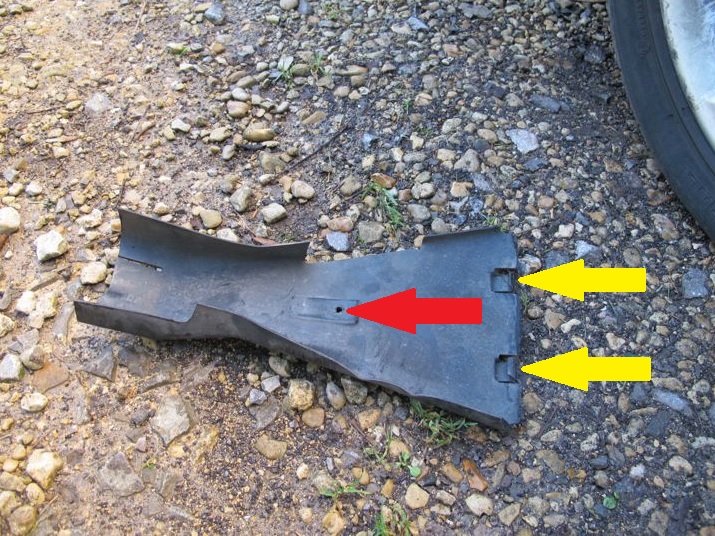

Old Jan 11, 2014 | 12:57 PM
The 2 cutouts arrowed in yellow clip onto the Undertray and the Duct is secured with a single hexagon bolt through the hole arrowed in red.

Exactly what does the generator air duct do--to what is it providing air?
Doug
Old Jan 11, 2014 | 01:27 PM
Posts: 25,864
Likes: 4,709
air flow to cool the alternator
