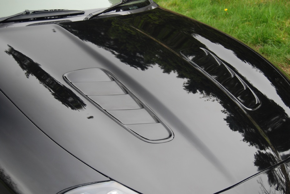

Here's an option. Grantley design louvers. They have a modern E-type feel and surely Grantleydealt with water issues. I looked at them but went fith the "controversial" Arden bulge vents to match my Arden style ground effects. Louvers-image.jpg
