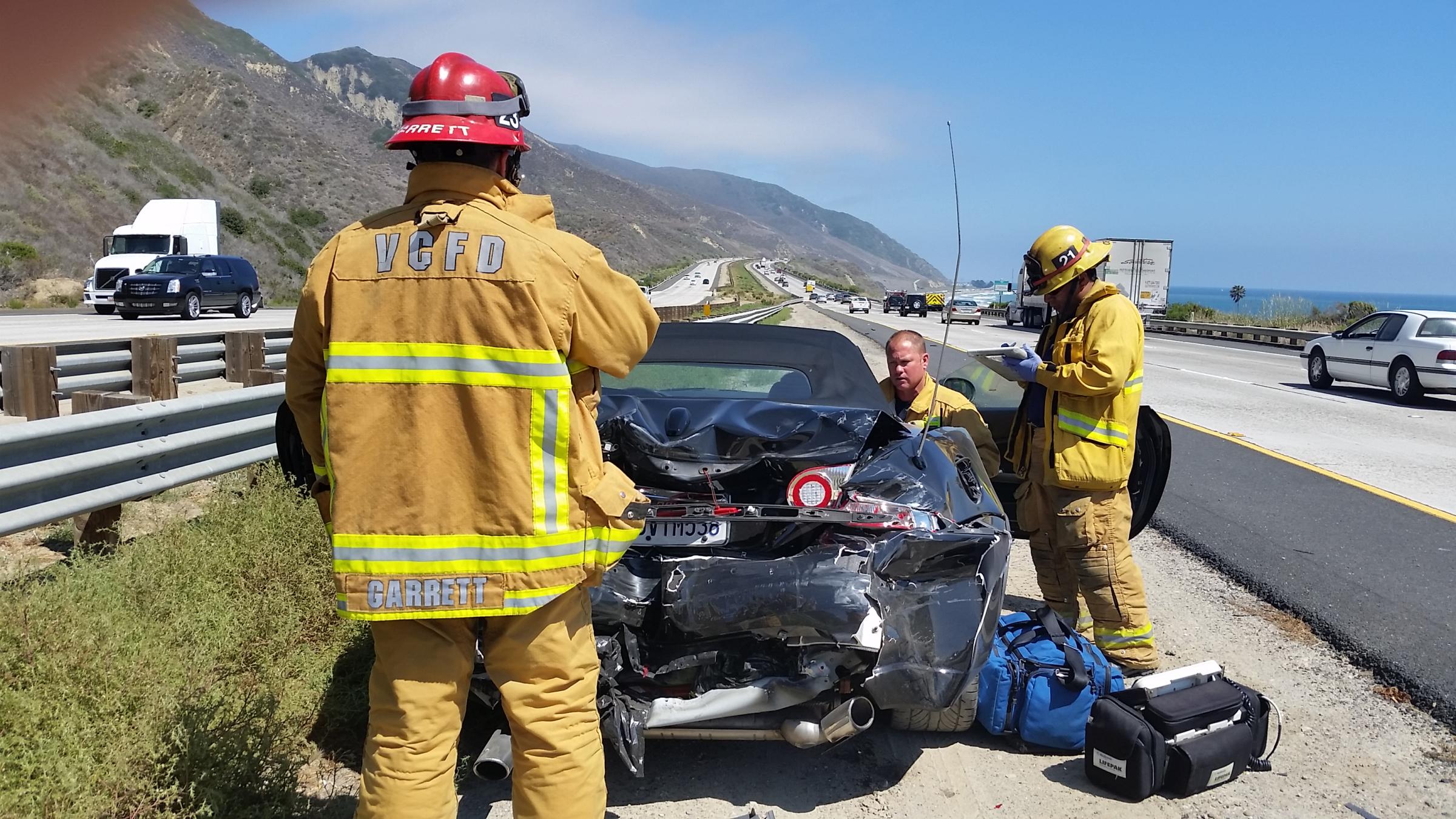

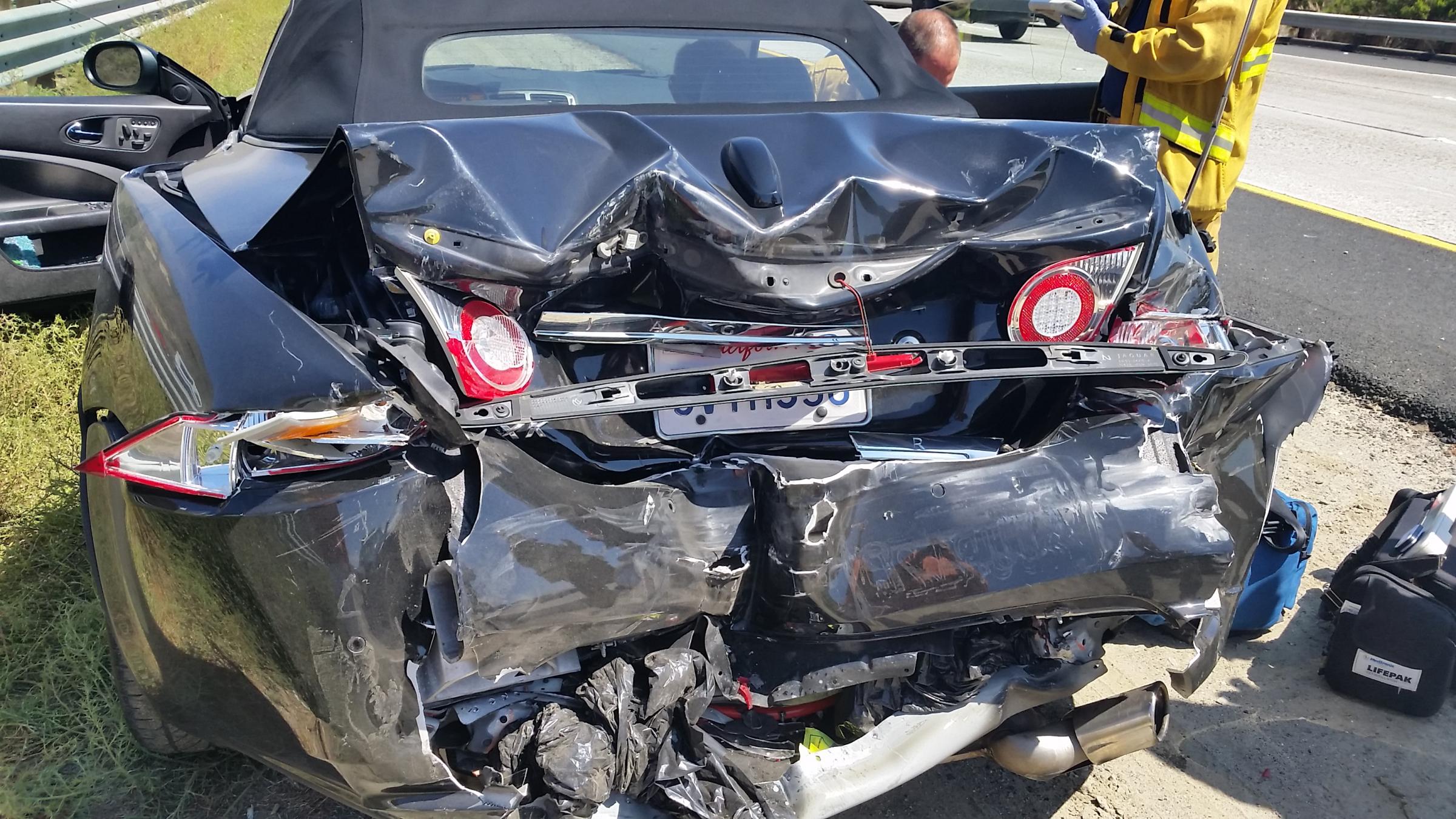

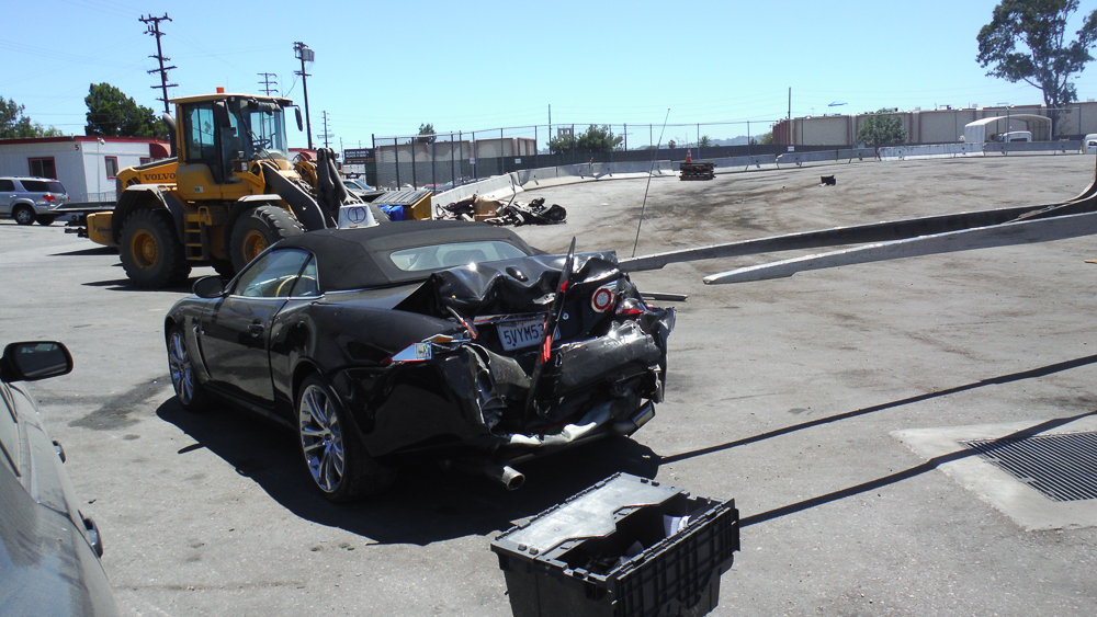

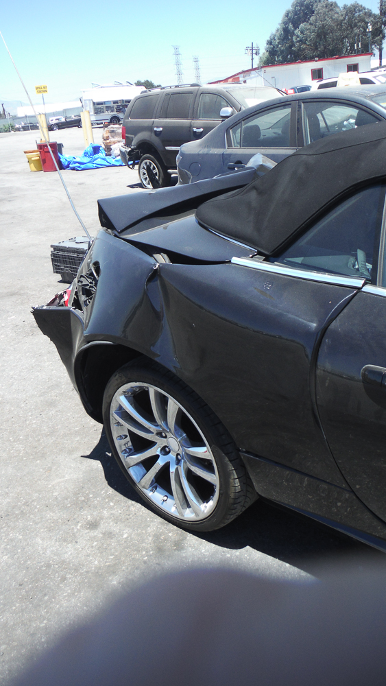

Haven't posted in awhile because fortunately the car has been doing great. Unfortunately I was driving down the Cali Coast line with my Dad on July 3rd in his 07 XK and while we were stopped in traffic, a Ford Expedition hit us going 65+. They had to remove my Dad from the vehicle on a Back board. But after scans and xrays at the hospital we both Walked away from the accident. The car folder exactly as designed. The Rear fenders buckled outward over a foot. The Front edge of the rear fenders where they drop in for the door folded forward, pinching closed the passenger door.
The body points behind the passenger seats where the windscreen was pinched inward about 4" compressing and shattering the wind screen.
Car was totaled, but it took good care of both of us. 48 hours later my Dad went out and picked up an 2011 XK with 18k miles and is back on the road.
