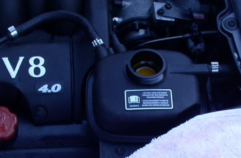

Likes: 17,018
As stated above, correct level is to the base of the filler neck:
The XK8 doesn't normally lose coolant. If the level has dropped significantly, the cause should be investigated as this engine does not take kindly to overheating.
