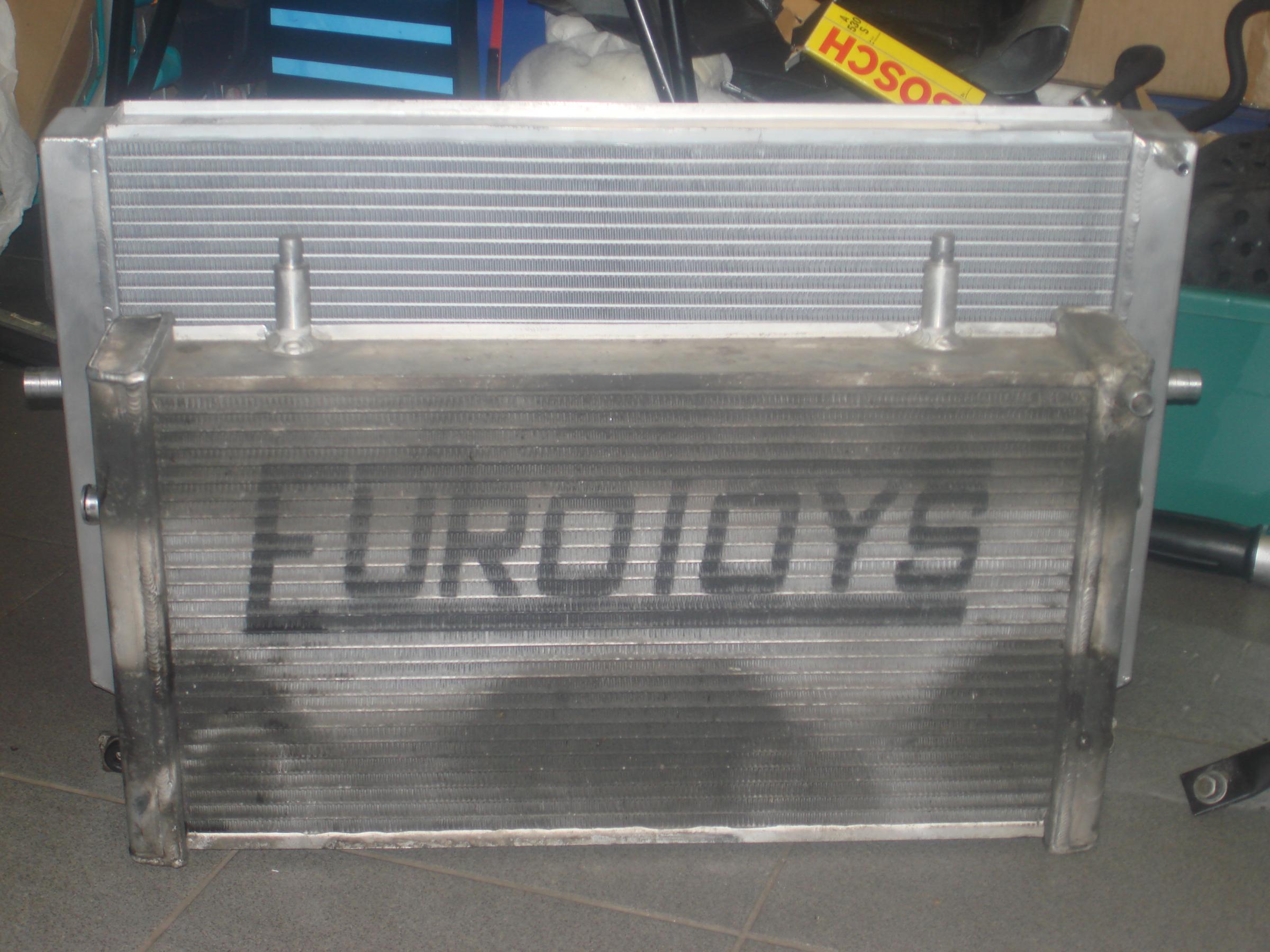

Be careful with thicker intercooler radiators, the disadvantage of these is that they allow less air to flow thru, which not only limits their cooling capacity but also lowers the cooling of the condenser and engine radiator behind it. The one ET sells is even so thick, that it sits also way to close to bumper, limiting even more fresh air to flow over the unit. Attached picture clearly illustrates this (and also shows one I have made with a larger surface area).
If you want to improve the intercooler radiator, then increase the surface area at least, and not make it thicker. I had tested a 50mm once, but even that proved too thick, going back to 32mm was directly a good improvement.
This will provide you more cooling power, so less powerlosses.
With regards to the lower pulley, the power comes in much quicker, however top end the gains will be much lower (this overall still gives a good feeling you have more power, don't disguard that). But the hotter the charge gets the less the upper gains become as the ECU will pull back timing based on the temperature. As far as I know (and to leave a positive to ET), his lower front pulley is ok as it doesn't fix the damper/harmonic balancer part as some other suppliers do.

Attached Thumbnails lower pulley upgrade real world pro and con-et-intercooler-vs-mine.jpg

For hot climates I would recommend a water/methanol injection kit to combat heat (Snow Performance). The larger intercooler radiators (either Eurotoys, or Avos's) add more of a Intercooler/coolant capacity which helps, but at some point that cooling affect would be overcome. For the street this would never be a problem, but if you planned on doing track days it could be.
I don't agree with Avos's radiator being any better than ours. It's not like we have the frontal cooling area of a Ford Superduty truck, most is hidden by the bumper. I have never seen any cooling issues on a XKR, or XJR with our set-up.

There are plenty cooling cores in the market. They affect flow resistance and heat exchange in different way, so that is not so simple.
Stock front heat exchanger has 50x28x3 cm core, that gives effective exchange surface of 3x50x28 = 4200 cm3
Stock two intercoolers have 27x9x5.5 cm cores, that gives 27x9x5.5 x 2 = 2673 cm3 of effective exchange surface.
My implication is: the best way to decrease charge temps is to produce better intercoolers which is not so simple They are the weakest part of the system. I'm not sure if placing bigger front exchanger would be a serious improvement. Have a look at the size of a stock front chargecooler, it's bigger than many main engine radiators of 1.4-1.6 petrol engines. I'm not sure if we need supersizing it.

2 cores behind each other will not double the capacity, remember, the 2nd one (or just like other thicker cores mentioned), will get hotter air already from the 1st one, so the cooling capacity left is already reduced. And next to that you lower the airflow, so again reducing the cooling capacity even more.
Anyway I use a 600x380 core, which is almost 70% larger in surface area then the stock one and the one from ET. I experimented with a 52mm thick core at 1st, but that was a waist of money, the 32mm one I have now is more efficient. The big advantage of this size is that it covers the full area as the main engine radiator, so when the engine fans come on, you use the full airflow capacity.
With a simple mod you can make also use of the stock engine fans, you only have to change the engine temp measurement (so a switch for example on the temp sensor line with a resistor that for example is equal to 97c, that will start for the 4.0 cars the fans at high speed, but the idea will also work for 4.2 cars). I don’t have this as the radiator I have now is adequate for my driving.
When on a dyno, I usually turned on the airco (as then both fans would come on) between runs to cool down the intercooler circuit, which not only helped, but also let me experience the time needed to cool down the system, with the radiator I have now it was the quickest by far.
PS For those that don’t go with my reasoning, I have good news, I have a 2nd hand radiator from ET for cheap.
How did you check it?
Old 09-05-2014, 10:26 AM
avos's Avatar
Join Date: Apr 2008
Location: Europe
Posts: 3,615
Received 1,062 Likes on 759 Posts
The iat#2 values (so temp sensor in the intercooler) are unfortunately not readable; it gives an odd voltage that you would have to convert.
I Have also used an 8 channel tmp sensor system (which was normaly intended for PCs) and his way I could measure different spots whilst driving, But I have no data left of it unfortunately.
But normally (when on the dyno) I just use a infra-red thermometer, that way you can measure different spots very easily.
