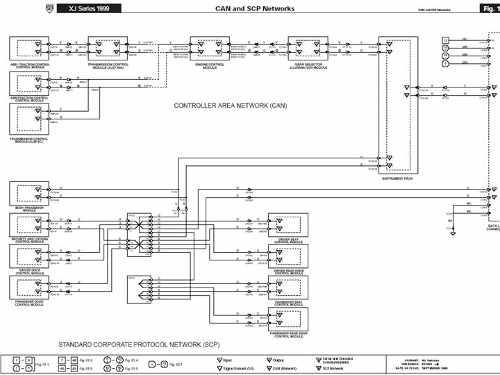

Hello all, sorry to be away from the Forum for a while, but I thought I would answer some of the questions here to clear up any confusion.
Our XJ/XK CAN Interface unit goes into the car in place of the original engine ecu and transmission ecu. We speak directly to the vehicle CAN, and in the appropriate language. So the car receives the software messaging, in the format it is expecting, directly from our unit. Just to clarify, there are actually 2 networks on these cars:
CAN (Controller Area Network)- this is the high speed network for high priority functions and includes engine controller, trans controller, ABS module, Gear Selector Module (around the shifter- the display), and the instrument cluster
SCP (Standard Corporate Protocol) - this is the low speed network for low priority functions including door modules, body control module, AC control module, lights, etc.,., and the instrument cluster.
The networks are completely separate, with distinct and separate wiring. The instrument cluster is the only module that touches both, and some data from the CAN is passed to the SCP there. For example, the car will not allow the rear defroster to be turned on (through the AC control module, on SCP) unless there is an engine speed signal on the dash. Same for control of the heater valve- no heater valve control unless there is an engine speed on the dash. Engine speed is CAN, defroster and and heater valve are part of the SCP. I'm sure there are plenty of other interactions as well. The SCP, and all of its elements, remains untouched and fully functional in our conversions- as far as the car itself and that network is concerned, the original engine is under the hood and working.
Also, please be aware that the instrument cluster does not contain traditional gauges/meters. All of the gauges, like all modern cars, are stepper motors, driven from the cluster CPU, which has its own distinct programming. So all of the signaling that registers on the gauges themselves comes into the cluster as software messaging, not hi/lo voltage signals like older cars. Besides the 2 CAN wires, there are no other connections between the instrument cluster and the engine controller or engine for engine data (except maybe the oil pressure switch/light/gauge which is an on/off dumb circuit)
Attached is a typical schematic of the CAN/SCP networks for you to see. This one is the 99 XJ8, but all of the 97-02 XK8/XKR and 98-03 XJ8/XJR are the same. Notice that the supercharged cars' transmission controller is tacked onto (not in-situ) in the CAN, unlike the NA trans controller. This may be because the Mercedes software/controller has some proprietary elements that they would not allow Jaguar to interface with.
