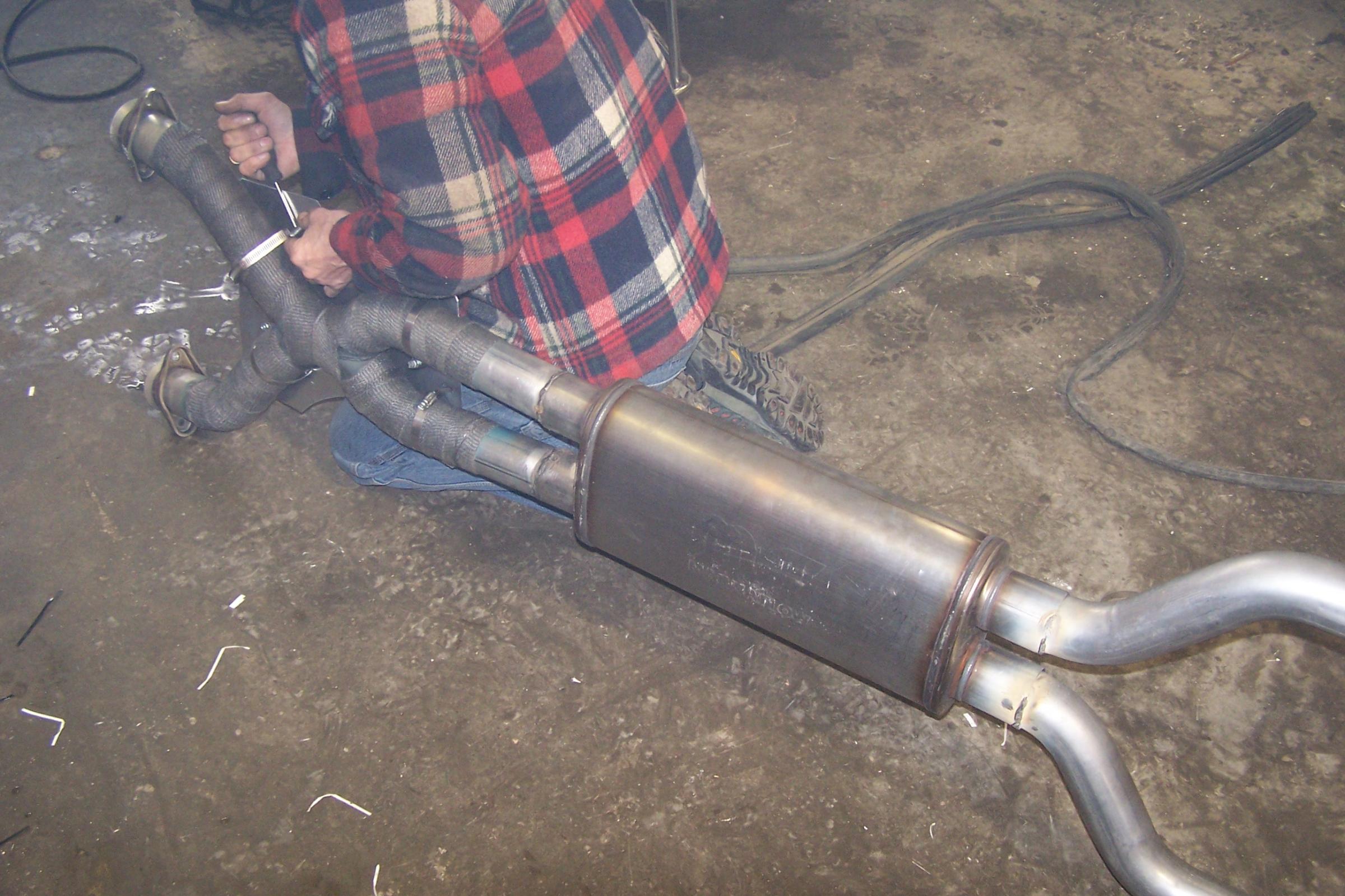

We pulled the donor drive train and the Jag drive train in the first two days. The most important thing we did was go to Staples and buy a labeler. We labelled everything we could on both cars as we disconnected stuff. Can't stress enough how this paid off later.
We needed headers and an oil pan and in Canada that is not a easy find if you are looking for used. Jag Specs came through with what we needed far cheaper then new and in excellent condition. Fortunately we have enough shops in this town to fab up the oil pan and the driveshaft. We did everything else. The manual is fairly comprehensive and easy to follow. We took the step by step approach or page by page actually.
Hind sight is 20/20 right? I advise anyone to read the entire manual thoroughly before work begins and in addition read all the "Tips" on the Jag Spec site as some things in the manual are explained there. Research is the key, this ain't no IKEA project. Jag Specs makes some assumptions and you may find yourself with an anomoly or two but don't worry because Andrew answered EVERY question (even the dumb ones) in a timely manner. I suspected the support was there from the beginning but never anticipated the level of service I received. Just had to put a Kudos in there for Andrew.
Once the donor was out of the way the drop in of the LS1 was fairly simple. Lots more room in the engine compartment than with the Jag mill. Surprised us. Routing of hoses and electrical was pretty easy. The only hard part was the alternator as the bottom bolt is so long we had to lift the rad a couple of inches to get it on. Should have put it on before we dropped it in. Hindsight again.
So here is who did what:
Troy - Mechanical
Works at Johnny's part store and is a fabricator/mechanic so he assembled all the mounts and manifolds and fabricated anything we needed or wanted to do differently.
Troy decided that he wanted to build a complete exhaust from the headers to the tips and I agreed. We went from a 2 inch exhaust with two CATS and four resonators to 2 1/2 inch mandrel bent exhaust with one cross over muffler. Bring on the ponies!! (no CATS req here in Kamloops)

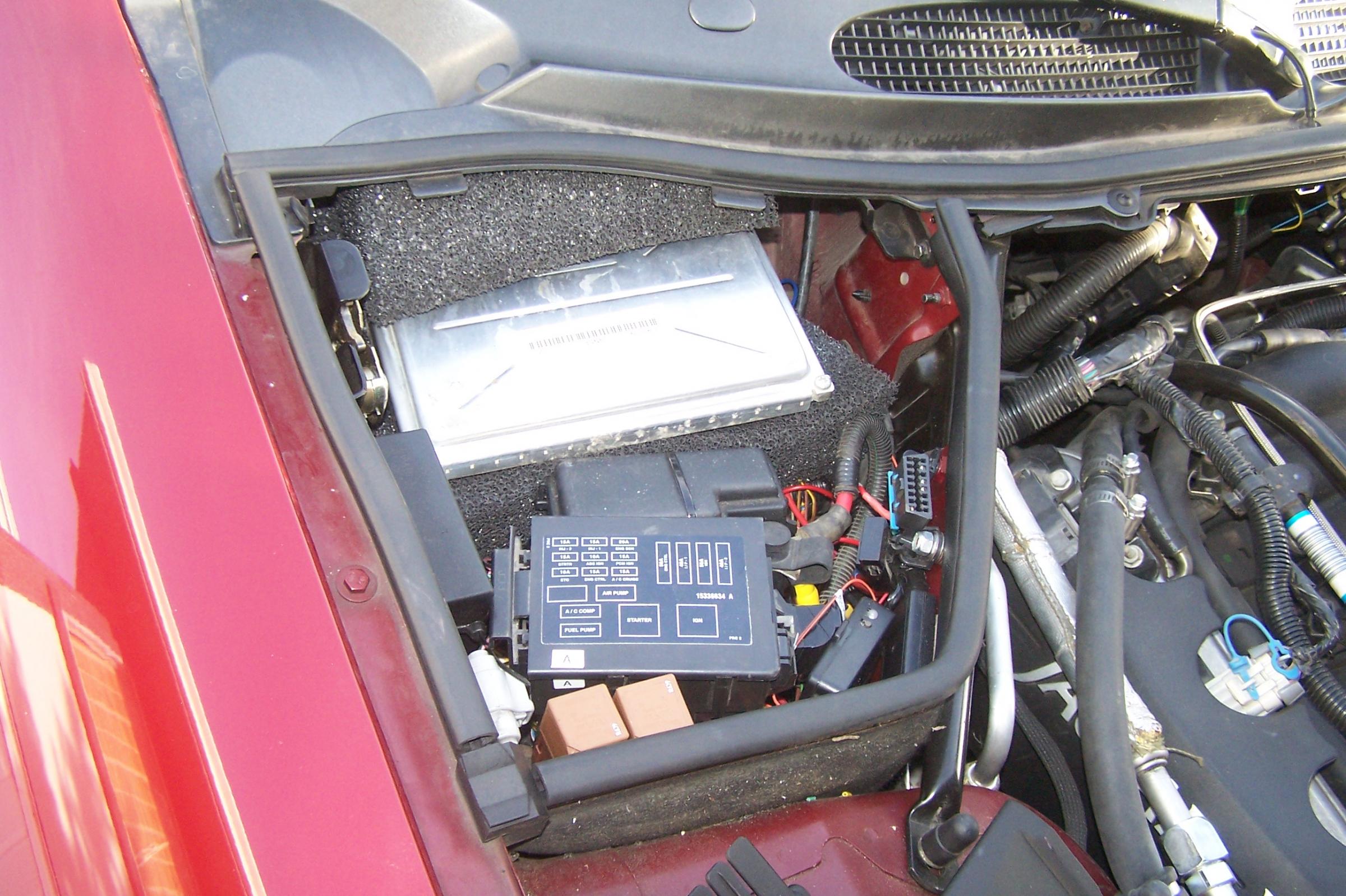

Me - Electrical
I did all the electrical and the PCM. This was a bit challenging but the more I learned the easier it got. Kudos to Jaguar Forums, LS1 Tech and Chevy Thunder websites for all the invaluable information I got from them. Chevy Thunder had every diagram I needed from the Camaro and Jag Forums provided me with a link to a PDF to the "complete" electrical schematics for the Jag.
I used this link: http://jagrepair.com/images/AutoRepa.../jagxk1998.pdf
I soldered and double heat shrunk each joint. No Scotchlock crimps here boys. I think electrical is the most intimidating part of this deal. I would not have even tried this whole thing if not for Jag Specs providing a module to make the gauges and other important components work. Easy to wire in, just read the instructions, take your time and have fun. I enjoy working with wiring so it came naturally to me once I got past the fear of blowing up a PCM. A word on PCM's. I discovered that the PCM is just a switching, powering and digital signal switching/sensing station. With the schematic I got online (for a 1999 Corvette) it was easy to identify all the leads and dive in. Didn't burn or blow up anything, not one fuse. That was a first for me ha ha. Most of the PCM functions do not need to be touched because they are related to the engine that came with the PCM so most of it is plug and play.
As I stated in Chapter 1 we started on November 11,2013 and fired it up April 1st 2014. Started first go. It runs great!!
