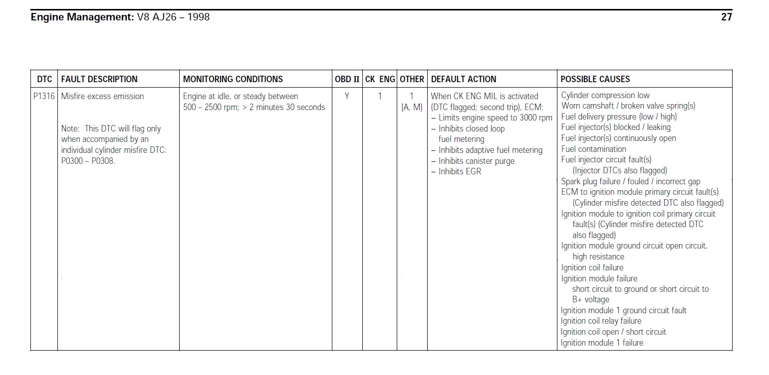

P0830 doesn't exist. Presumably a typo for P0308 which is misfire on B4 (8)
Possible causes of the related DTC P1316 are:

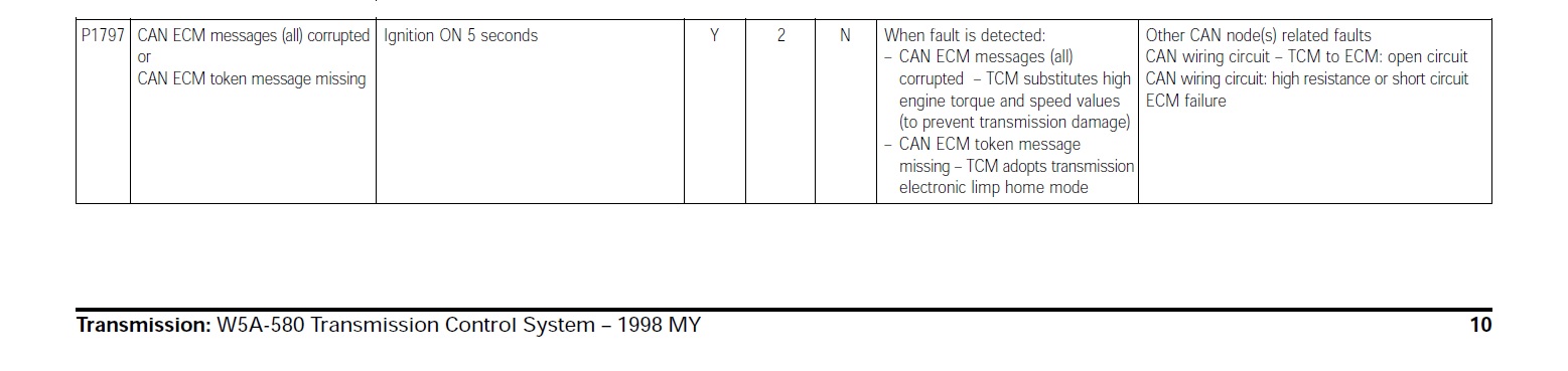

Presumably you've used a generic lookup for the DTC code descriptions? This is often misleading. For the 1998 XKR, P1797 is a transmission error code:

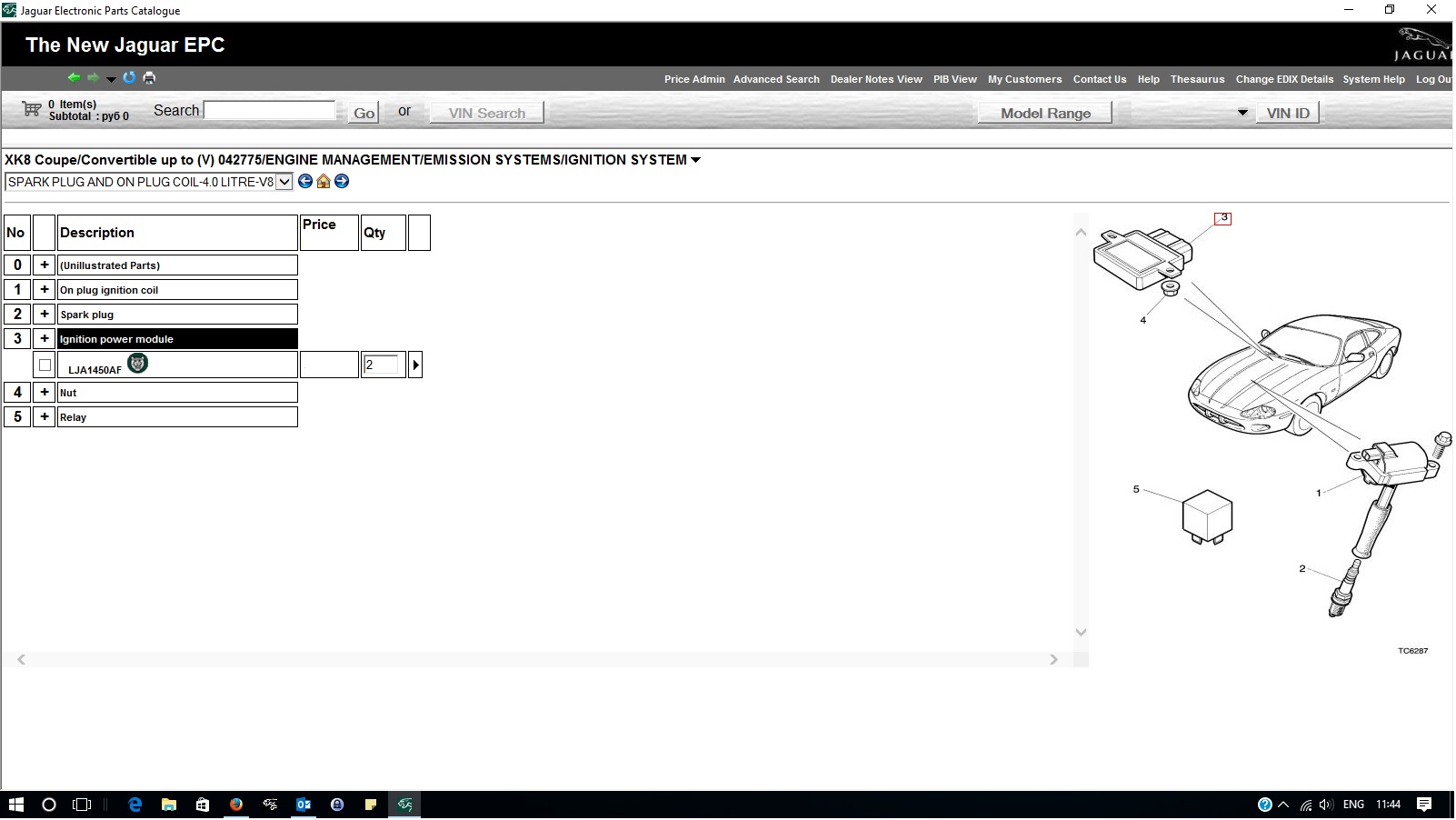

If I've followed the trail here, you have a consistent fail on Cylinder 8 confirmed by coil swap and also found oil in the plug hole well.
I don't have a photo of the Ignition Module but the illustration (see item 3) from JEPC should help identify them:
Oil leaks from the cam covers is a regular issue. The main perimeter gaskets fail (usually at the rear) and also the spark plug boss seals (O Rings) which allows oil to leak and collect in the plug hole wells.
