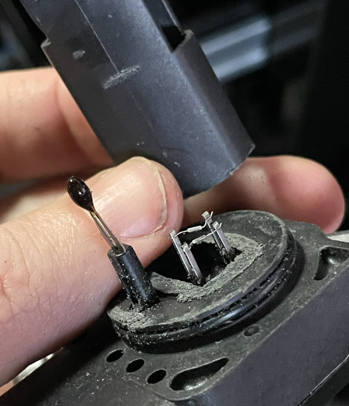

For fun, I took one of the MAF sensors that didn't work and cut it open. When you spray that MAF cleaner in it, this is what you are trying to clean:
The big one on the left above is the IAT sensor and the two little wires are the MAF sensors. They are a very crude design in that they measure air flow by heating the wires up and measuring the voltage needed to maintain that temperature as the air flow tries to cool them. As you can imagine, if they are dirty, shrouded, corroded or otherwise non-sterile, they will not cool the same way and will thus read incorrect air flow measurements. In my opinion, these wires are robust enough to survive a cleaning with a Q-tip, however they are stacked on top of each other. If the bottom wire is soiled, you will not be able to manually clean it.

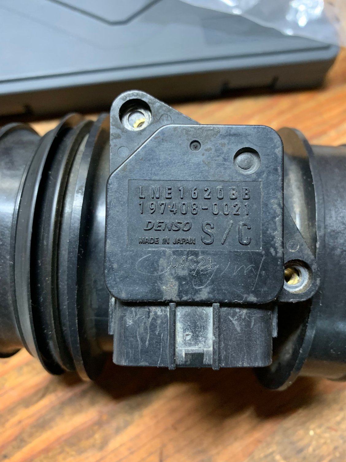

These three different MAFs all have the same LNE1620 part number, and only the third one below works for my 4.2 XKR:
Note this first one is the only one that has the "correct" part number written on it, and even says "S/C"
This last one (which works in my car) has a strange opening on top that the others do not. If anyone understands why it has this, I would like to know.
