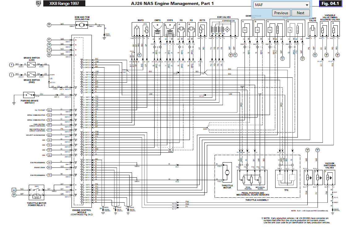

Hi everyone, it has been a while for me.
Here is my latest project, 97 xk8 I just replaced the passenger side cylinderhead with a 98 model, we filled the hole where the additional cam sensor went. Here is my issue, I can get the car to fire but not well. I replaced the maf sensor plug as my one was destroyed, they seemed to have different color wires in different plugs. I soldered the wires based on the old 97 plug.
My question is does anyone have the wiring for the maf sensor so that I can check if I have done it correctly? Is the 97 different than the 98?

Here's from the jtis,

Thanks, do you have any tips on the timing? I replaced the cylinder head and followed all the instructions to time the car, is there anything I missed?
Something to check as I may have to disassemble and recheck everything if the maf sensor wires are correct
