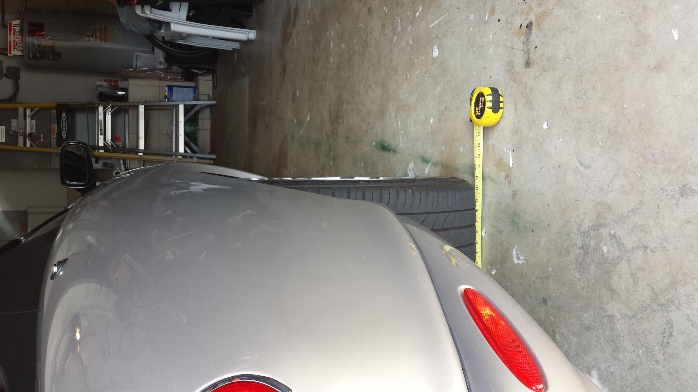

I think they might fit... it depends on the offset of course... and the spacer thickness and how that affects the offset... and how low the back end sits.
I have 20's on mine that are around 10.5-11" wide and I could easily go out wider...
I took some pics to show how mine looks...
Attached Thumbnails Massive alloys-2015-02-17-11.17.24.jpg   Massive alloys-2015-02-17-11.17.30.jpg   Massive alloys-2015-02-17-11.17.58.jpg   Massive alloys-2015-02-17-11.18.34.jpg

They are Avant Garde M310's... I had to have the hub bore widened about 2mm or so but other than that they fit perfect. I bought them used off of Craigslist in perfect shape with tires - they were on a BMW 5-series and the guys lease was up so he was selling them.
