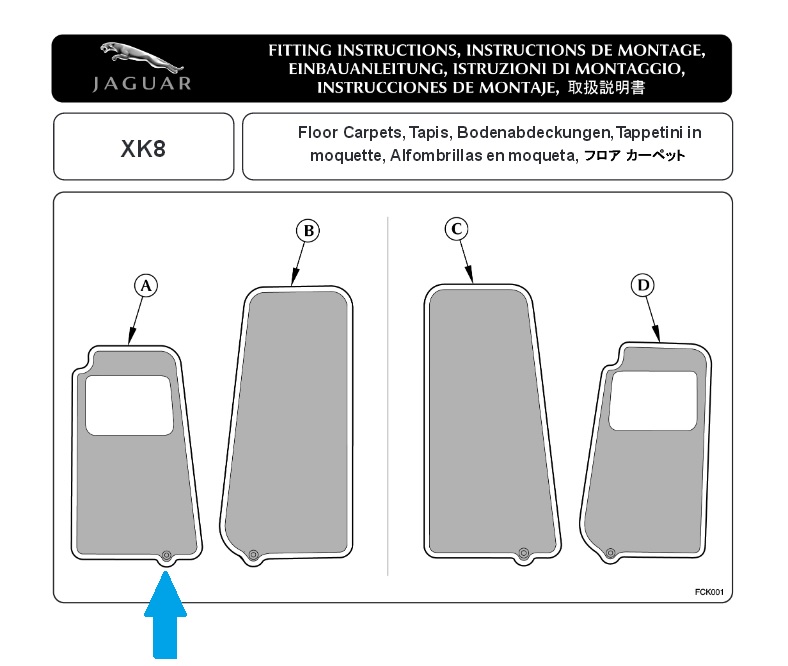

I presume this is the removable driver's and front passenger's mats?
If so, they were originally available from Jaguar in carpet, lambswool or rubber options but you are unlikely to be able to source any Jaguar OE now. However, they are widely available from aftermarket suppliers.
For the 1996-2006 XK8/XKR there was only one basic pattern change through the production run. This is the single or double fixing holes:
The number of fixing holes changed with model year.
Graham,
Thanks, I just checked and I have 2 fixed holes that are located at the bottom of the mat on both the driver and passenger side. Nothing at the top. I began my mat search yesterday and came across a few companies, two of which were mentioned on a previous post.
