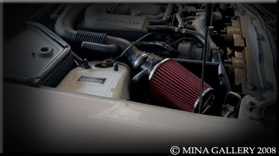

Here's a picture of it on the Mina site, it still looks less than desirable as it's still in the engine bay:

Default Separation panel
Yes, mine had the separation panel as pictured. It is an insufficient design, allowing hot air to *easily* blow all around it. It is not custom fitted to seal off hot air. Those 'heat blocker panels' are for marketing purposes.
Hot air is *horrible* for performance.
If you're going to pull air into the intake from inside the engine bay, you can't beat a modified factory air box for cold air intake. It is truly sealed off and has snorkels that reach out to the cooler air. They even provide more air than a 3.5" custom intake can pull in by several square inches.

Since I have an STR with a Mina intake, I can't attest for the XKR, however, the STR has plenty of room for the air filter to sit where the stock airbox sat, and there's generous size passages for cool air to reach the filter element from the headlamp area and underneath.
