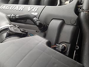

Have a 2000 XK8 convertible and have a minor oil leak spotting the garage floor under the very forward part of the passenger side engine compartment. It appears to be coming from an electric "sensor" of some sort located on the top right corner of engine passenger side. Have been told there is a gasket that should be replaced.
What is this "sensor" called and function... and does it take a special tool to remove and replace it?

From your description, it sounds like the VVT seals (round, maybe 2" in diameter?). They are available on eBay and other places. They simply pull off with the (gentle!) help of a screwdriver or plastic knife. Just disconnect the electrical plug to free them off. The area needs to be cleaned off of any oil residue, then the new seal pressed in, by hand or any blunt tool to apply some pressure. 10 min job.
Part# AJ82856
That being said, these seem to harden over time and leak just a bit of oil (and allow air in, too) over time. Hard to see these being the cause of a puddle of oil, but you have your own car in front of you...
Best of luck, keep us posted.

Here's a photo attached... It's the "sensor" in the lower right corner of the photo.

Yep, VVT solenoid...

Is there another VVT on the driver's side engine bank?
Yes, and you probably should change both.

Be aware that some of the really cheap aftermarket VVT O-ring seals do not last very long before they start leaking again. One pair that I paid about $18 for started leaking within two years of install. The engine bay heat constantly bakes these O-rings, causes them to get hard and brittle, then they lose their ability to seal both air and oil. Buyer beware....
