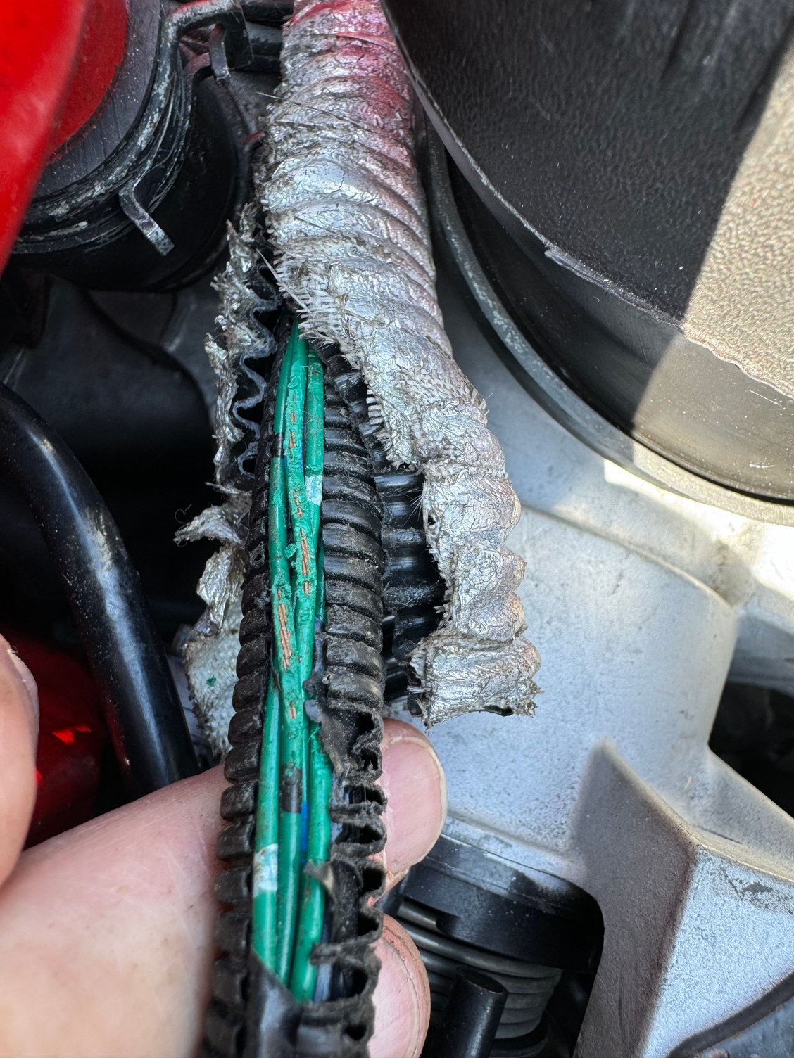

I have found three wires from the left bank of coils which have damaged insulation on the loom that runs round the back of the engine. None were touching each other so might not have had any affect. It was covered with an extra layer of conduit so must have been like this for some time and covered up in the past. I will insulate them individually.
