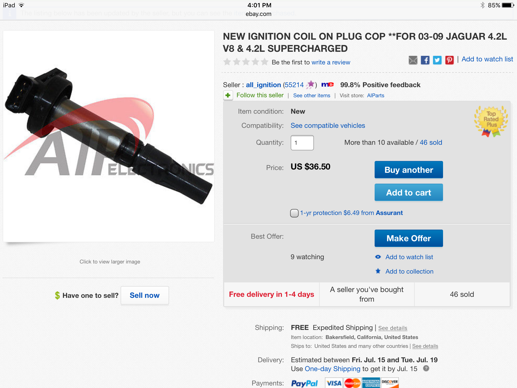

Well what did I have to loose? $17.42 that's what! Got the coil today and it threw a P0356 code, moved it to cly 8 and it threw a P0358 code. New coil does not work on my car! Pc of s**t!.
Ordered another one that's more expensive for a different vendor, will see if it works.

Well second time is the charm, this coil worked perfect
