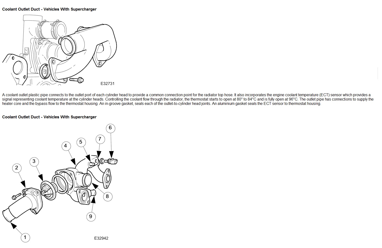

Originally Posted by johns55
Does anyone know what the correct temp range should be?
JTIS states "the thermostat starts to open at 80 to 84 deg C (176 to 183 deg F) and is fully open at 96 deg C (205 deg F)"
Note this applies to both Normally Aspirated and Supercharged models.
