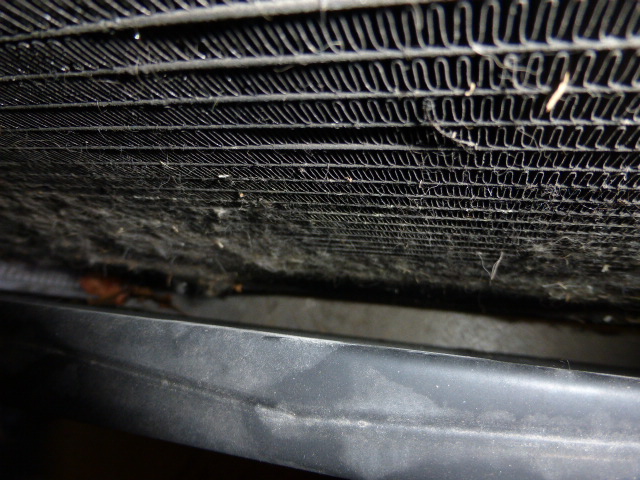

anywhere in the 195-205 range should be considered normal for any modern alum engine IMHO. 220 and I'm getting pretty nervous. 225-230 and I'm calling the rollback for a ride.
Have you pulled the plastic upper radiator retainer piece off and checked for debris between the A/C condenser and radiator core?

Russ, the problem is that IR gauge says everything is good, the TORQUE app and RealGauge say that it is not.
