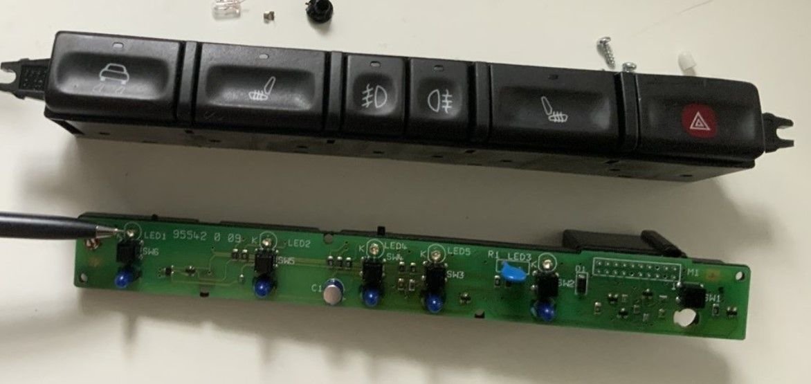

I have now got the PCB in my hands and I can see nothing wrong with it. None of the small LED tell tale lamps light and I'm stumped so I think I'll have to wire in a replacement tell tale as suggested.
I cannot see the common line/wire on the PCB the LED share. The blue illuminating LED LED work OK - apart from one which has broken.

I can't see any issues with the board. I do have a friend who can test these things but he probably will take some persuading. I have a system that should now pass the test.
