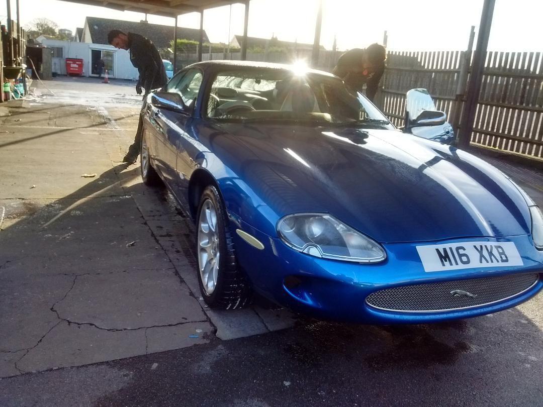

On the rust question I live half a mile (as the seagull flies and invariably craps on my car) from salt water, so have had the sills and floorpan done, it's not too expensive, what IS is the chassis legs as that's an engine out job. Pic of my (now defunct as of July this year) 96 car below:
