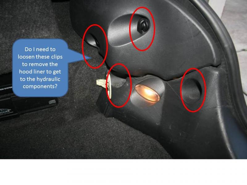

I read some of the previous thread and from some of resources available from the FAQ section.
So it seems like to get to the roof hydraulic components (pumps, relays etc) I have to remove the trunk liner. In order to do that - I need to loosen all the clips on that liner as pointed on the picture?
Also - I took a screen cap from TSB 501-11, and I found a failure mode that's is most closely matched what happened to my car. Low voltage is #1 as the probable cause. I think I'll drive the car for a while and see. Come to think of it - maybe a new battery may not be a bad idea. I think I still have an original unit - which is amazing considering that it is a MY2003 car. My 05 Accord is already on its 3rd battery.
Am I on the right track here?

To get to the hydraulic pump for the top you really do not need to remove the plastic piece where you drew circles. All you need to do is pull back the stiff material that is fore of that piece. You can pull that material which is pretty sturdy by flexible without removing anything else, although it is sometimes easier to first remove the similar material that is in the trunk right behind the rear seats (pulls right out).

Thks Doug - so essentially the liner that also in-a-way framed the CD magazine and the Nav player? That thing just pulls right out?

Right--that liner that covers the CD and NAV also covers the pump and could be pulled back to gain access to the equipment rack that supports all of those items. While you are doing that you might also consider installing a check valve on the pump if there is not already one on it.

Bob, it pulls right out, but much easier if that tail light cover is taken off first.
