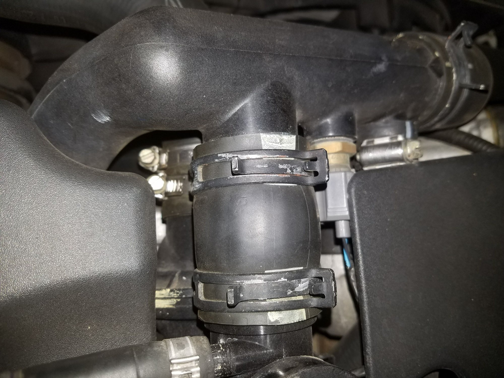

The hose in question is this little one.
When I did my oil change, my mechanic suggested I "keep an eye on it".
Your thoughts?
Any PREFERRED coolant?

I run the Prestone DexCool in my '03 XKR as well; do not mix different colored coolants as this could result in the 'coolant gelling'. Coolant colors have become fairly standardized, but you may still come across a 'Universal Coolant' that does not meet the standards of the Cooling System.
If you are talking about the short length of hose that appears to be bulging at one side, you will notice if you look at the picture, at the bottom of the hose, and can barely be seen at the top, that there are two 'shoulders' molded into the pipe, one at the top and one at the bottom. You can also see that this hose was cut to size and unevenly at that. This makes it too long and uneven, with one side being longer, and the limited space, and the side that is bulging is longer and is pushing against these shoulders and the extra rubber material from the hose is bulging as a result. Mine appears the same except the bulging is uniform, and I can clearly see on mine that it was a 'cut to fit' piece of hose, and was cut too long to fit properly and is bulging out as a result. You could probably trim that piece in situ, carefully with a box knife, remove some material from the uneven side, release pressure from the clamp, and 'smooth' it down, and back to a uniform shape eliminating the bulge at one side and re clamp the hose. This way you do not lose coolant from the hose, but you should still 'burp' the system after you are done, squeezing the hoses from the bottom up to expel air from the recovery tank.
However, if you are talking about the smaller hose that is on the bottom left corner of the picture, that looks like the crappy clamps that were used instead of a 'washer, or gear clamp' has degenerated and is no longer capable of holding the hose tightly to the fitting, and it is being forced off as a result. That hose on the lower left corner may also be leaking coolant under pressure, judging from the white flaky residue that is around the fitting pipe where it has slid back. The type of coolant leak from the smaller hose would go undetected, and lower your tank a few ounces a week or so, and evaporate as soon as it hit the hot engine, removing traces of a leak. That hose does not need to be removed either, just push the hose back up the fitting, remove the old clamp, and open a 'washer clamp', so that it can be wrapped around the hose without removing the hose, and thread it back into the gear and screw it down tight to secure the hose.

Thank you.
I'll address accordingly.
