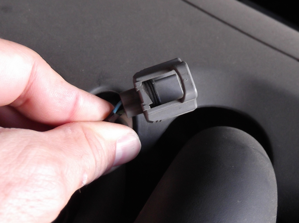

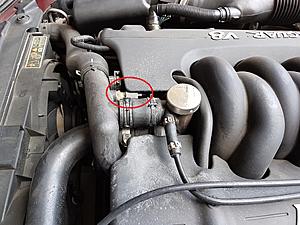

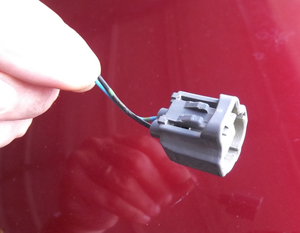

The clip that holds the connector on the Temp sensors breaks and when you accelerate rapidly, the temp sensor becomes unplugged. The plug is right on top of the manifold near the thermostat tower under the right side cover.
You get restricted performance and the temp gage goes to zero.
Happened multiple times to me, before I fixed it.
Went to junkyard, cut the pigtail with a unbroken connector off another Jag 4.0L and soldered it in. Problem solved.
Old Aug 2, 2017 | 10:13 PM
Ungn's Avatar
Joined: Jan 2016
Posts: 1,177
Likes: 375
From: Southlake, TX
Attached are pictures of the sensor location, the broken clip and a repaired clip.
It may be a long shot, but it what gave me these errors on my '97.
Attached Thumbnails My first "Restricted Performance"-temp-sensor.jpg   My first "Restricted Performance"-dscf7115.jpg   My first "Restricted Performance"-dscf7125.jpg

Ungn: Yep, that's what happened. My crossover pipe failed a few months ago as it was the original micarta (?) material. It went soft on the ends and when removing that very clip, the little tab popped off. (God bless the Jaguar procurement agents for selecting such fine, fine plastic materials...) After installing the new pipe, I reattached the connector and promptly forgot about it. Yesterday while getting a haircut I was thinking about the clues I typed in my original post and remembered that clip. when I left, I popped the hood and saw the connector completely unplugged. I then scorched my wrist on the thermostat tower, plugged the connector back in and turned the key. The restricted performance was gone and the temp gauge worked again! Today I'm going to use some tie wire to ensure the connector doesn't come off until I want it to.
KITTY IS ALIVE AGAIN!!!
