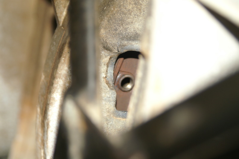

Good day everyone!!! (Something is telling me to go for a swim as this is the second time I've had to post a message twice! And this was a lot to post for this one!!)
Okay, first things first... Here is the small hole in the flywheel that only comes around once per revolution... There is also a shot of one of the welds...

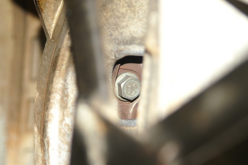

And the torque converter bolt...

and one of the (blurry) threaded holes that has no bolt... The threads look clean as if they have been used... But what would they be used for on this car? Hmmmm.......

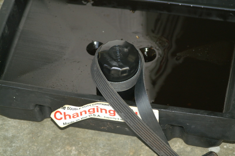

I forgot to take a picture of the oil pan at the drain hole... I will be replacing the oil pan in the near future...

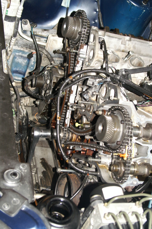

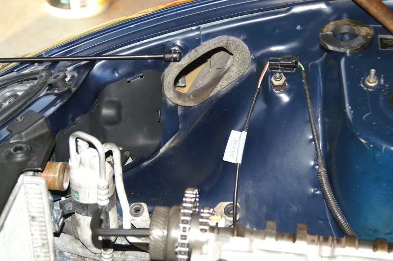

Here is a shot of all the timing chains in place... Kinda because I am waiting on two tappets (lifters) from the dealership... Once I get them, I can install the exhaust cam on the pass side... I also don't have the cam bolts tighten or the cam caps installed... I'm still turning the crank TRYING to locate the starting point mark for setting up this timing...

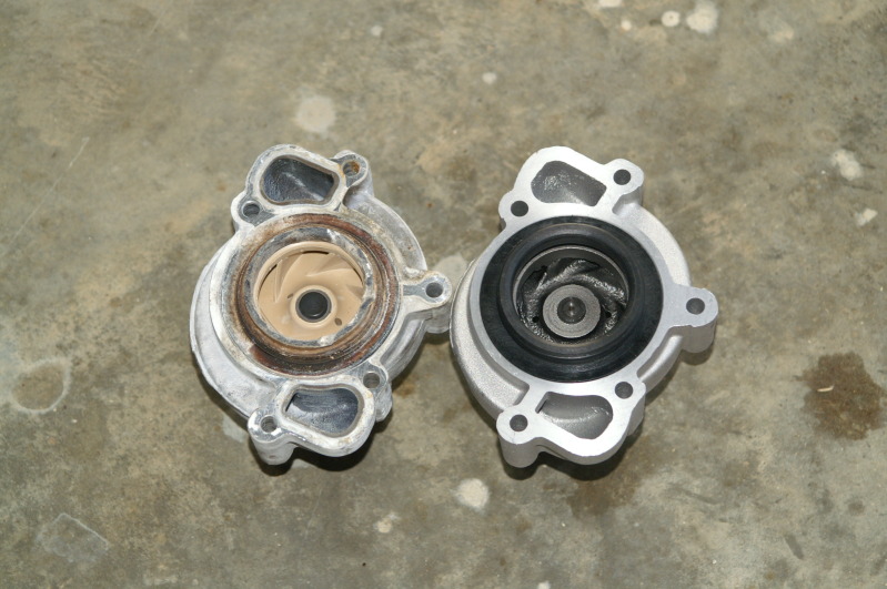

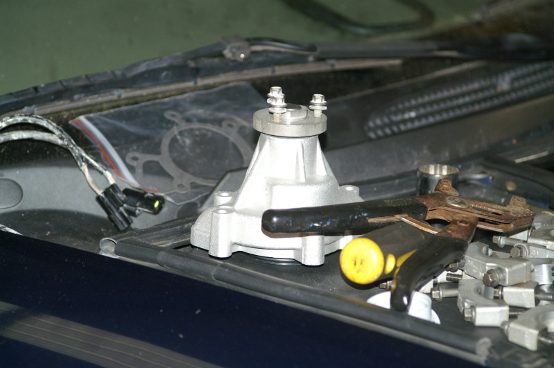

Here is my new water pump... And next to my old water pump... This new one has metal fins, but the price for the dealer pump wasn't much different... I went with this one cause it has the metal fins... The dealer confirmed they still have the plastic fins... The fins on my old pump are still good... The plastic border that holds the big O-ring failed, which is the same for the new one... Hmmmmmm...

I have to mention this funny part that had me a little worried... Do you see that little red oil checker thingy?! Well, I pulled that out after I took the head off to clean it and check the O-ring... Well, I didn't put it back BEFORE I put the head back on... It took me over an hour to figure out how to get that back in there without pulling the head again... As it turns out, if you pull the PS pump, you can wiggle it back into place without bending it at all... I was worried!!

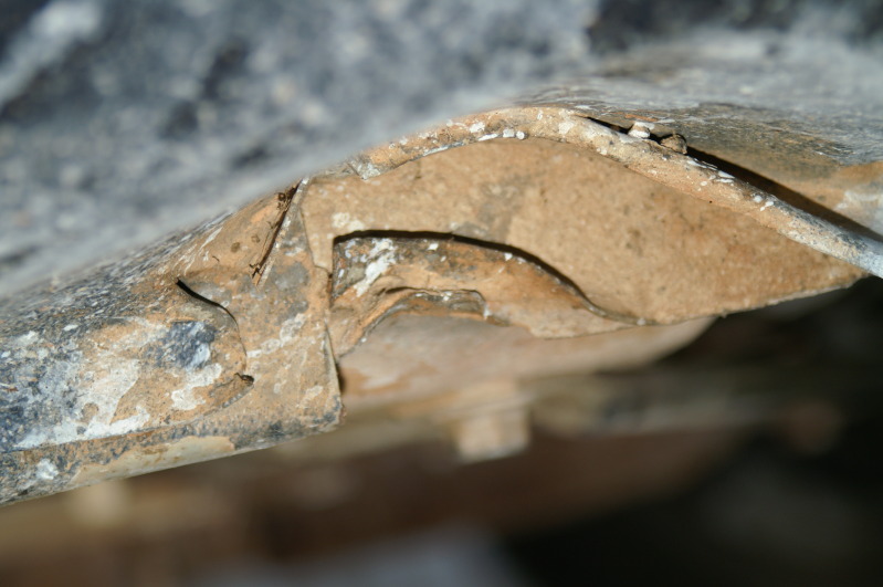

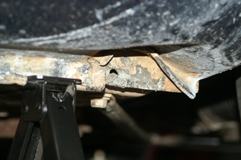

I'm not going to refer to the person that worked on this car prior to me getting it as a MECHANIC anymore... He put the oil filter on so tight I had to use my last resort method (short of stabbing it with a screwdriver and making a complete mess)... If I can get the accessory belt around the filter, I have always gotten them off... I was in doubt my failproof method was going to work today, but it finally started turning...

Well, this is about the extent of my body work abilities... I have to pull the inner fender plastics to get to the main damage, if I can even get to it... Here is my 1st "after" picture...

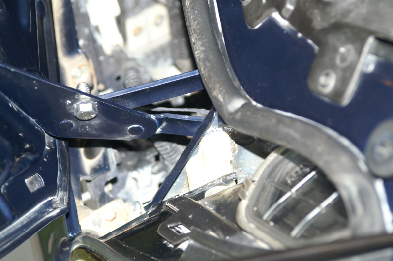

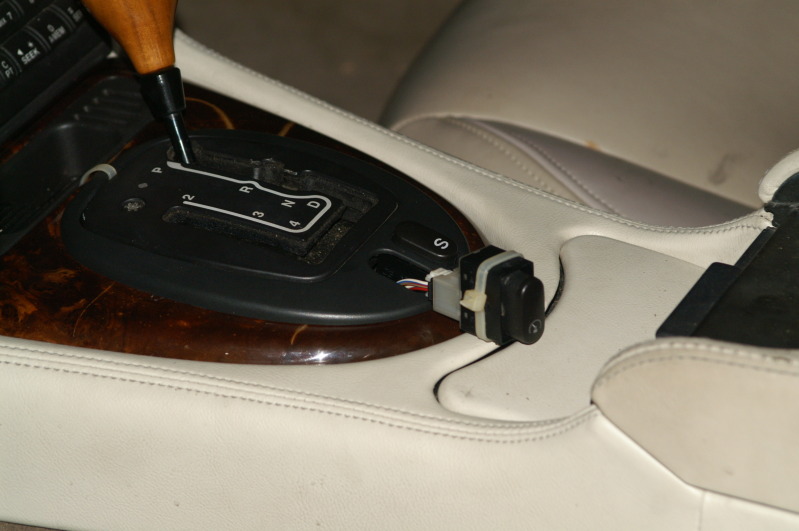

And finally, the shifter... I tried to get the broken cruise switch to stay and I got it to work, but it wouldn't install due to the fix... Soooo, I will just have to purchase a new cruise switch to finish up the final touches to the interior... I noticed that the center console looks whiter than the other leather, seats included... Did they come like that?!

Well, what I couldn't get in the pictures was the actual "tone ring" that sits just above where this "mark" should be... The flywheel is actually the tone ring... The square holes are equal all the way around except for one section where it's like two holes are combined... Unfortunately, I don't remember what that trigger point was by... It may have been the small hole, but I can't say for sure right now... This method is great, but the older method took the guess work out of getting it right... I like the timing marks on the sprockets and chains...
Thanks much!!!

Hey Blue...what you are missing the the official Jaguar flywheel locking tool. See the small tool in the center of the picture: Jaguar Timing Tensioner Tool Rental - Jaguar Service Tools
Old Aug 14, 2012 | 08:33 PM
  #116
bluexk8ragtop's Avatar
Posts: 165
Likes: 22
From: Lexington, SC
Good day!!
I know I have to pull the CPS and install the tool, but I can't find the "triangluar arrow indent" as the procedure says to know when to install the tool... I only have holes, bolts and welds... I don't think this is the original flywheel...
Cheers!!

It is supposed to be 45 degreees ATDC cylinder A1 if you can manage to figure that out.
