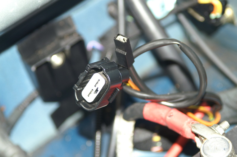

These were just hanging out with the relay sockets, but I have NO idea what they go to... There were no open spaces in the fuse block...

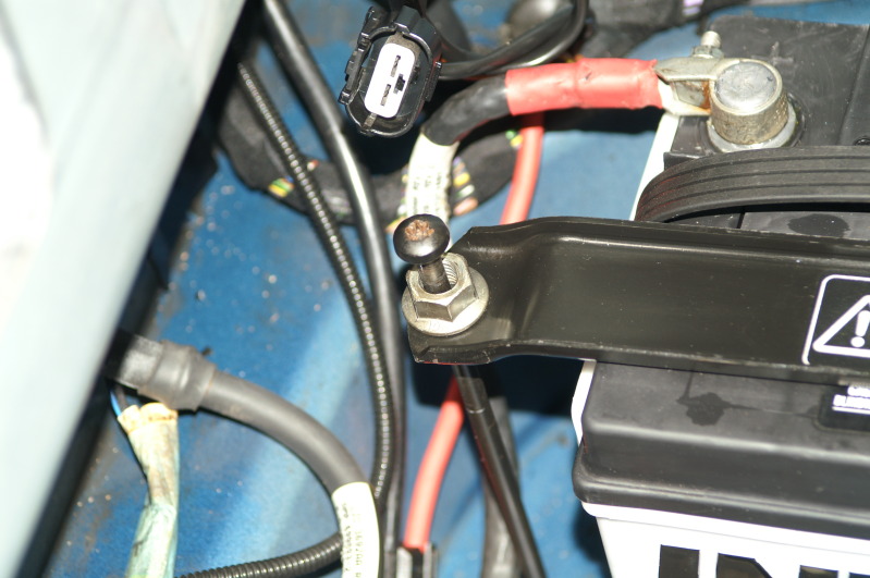

These are up by the positive side of the battery... Again, I have no idea what they go to...

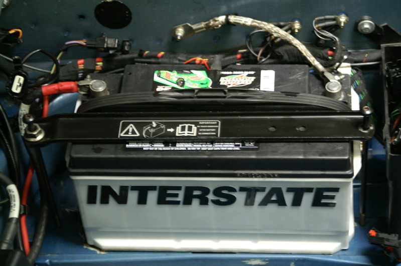

Here is the battery... I had to leave it on the charger for a couple hours to bring it back to life... Should there be a tray under it? Seems odd to have it just sitting on the bare metal... Also, the mounting bolts are maxed out on the threads and a previous owner had to put that bolt in there to take up space...

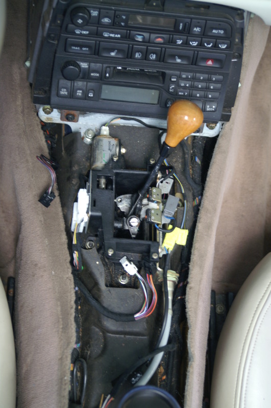

Here is the shifter... Destroyed!!! Still functional for gear selection, but REALLY!? The console wasn't bolted in place... I think these black torx bolts hold this stuff down... But, I'm guessing as there isn't much else to choose from...

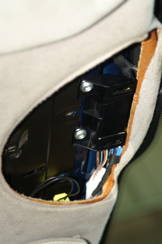

No interior light... Really!?

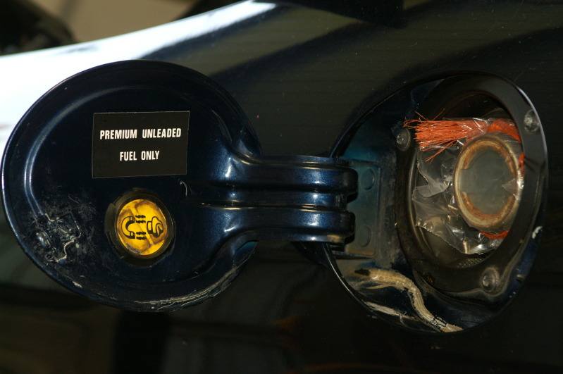

No gas cap!! And they tried to SUPER GLUE, yep... SUPER GLUE the gas door locking bracket to the door... AND got glue all over the place...

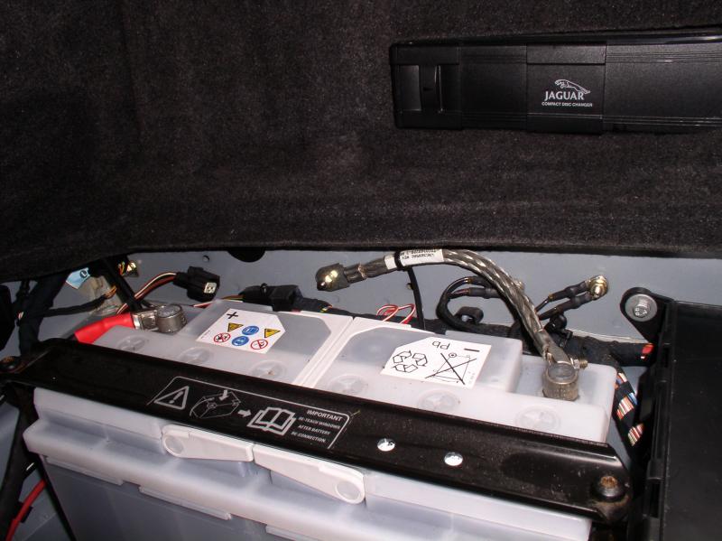

The battery doesn't have a tray. It sits on the floor like that. The problem is the one fitted is too small. It may have the right capacity but should be a taller battery so the securing strap doesn't need and extra nuts or washers.
This is my 4.2 but the earlier 4.0 litre model is the same:
Another thing on battery type. The original Jaguar batteries have a vent pipe from the left hand side (nearest the fuel tank) which vents gas out through a hole in the floor.

That is what I was thinking too... Oddly, the original batteries look more like BMW version than Ford... Mine has the vent tube, but it is on the side nearest the CD changer and way too short... I had to lengthen in to reach the vent hole, which I'm guessing is in the corner where the open connector is in your picture...

YES - in my picture, the vent is beneath the black retaining bar.
When you buy a new battery from Jaguar, the vent is separate. The battery is plugged at either end and you have to remove the left hand plug to fit the vent.

I was confused a little until did a reboot and read what you typed again... The vent out of my battery is by the CD changer, but where does the tube go from your battery? I put mine through a rubber grommet in that corner by the gas tank... I was guessing as the previous owner had it just haning down; venting into the trunk...

Just in case it wasn't clear, the batt. vent can be moved from one end to the other of the .cover. At last it can on my batt.
