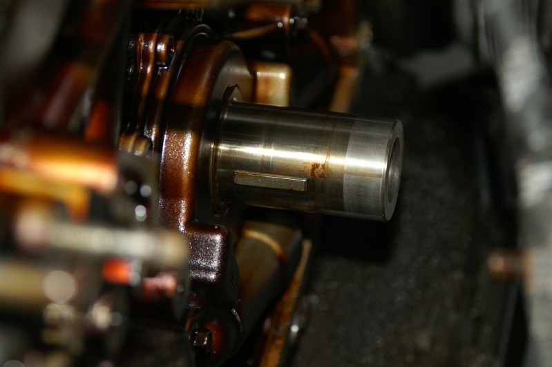

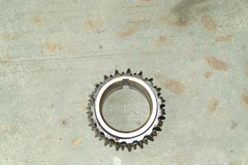

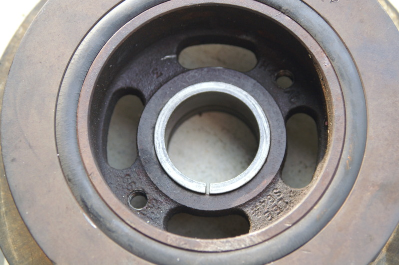

Here is the crank pulley and the locking device... Soooooo, the more you torque down on the puller, the tighter it gets!! GOOD TO KNOW!! I think the easiest way to pop this off is to spray some good stuff on it, and get a socket that fits around the steel insert; touching only the crank and give it a good solid whack!! I'd imagine you'd be able to pull the thing off by hand at that point...

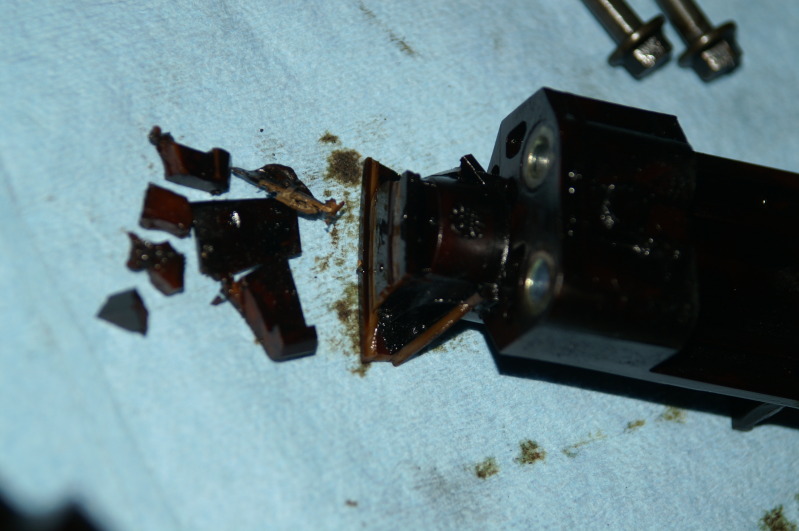

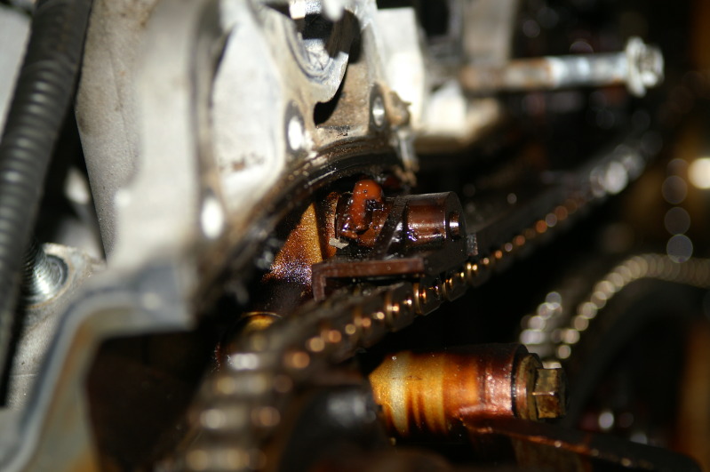

Here is another part of that broken tensioner...

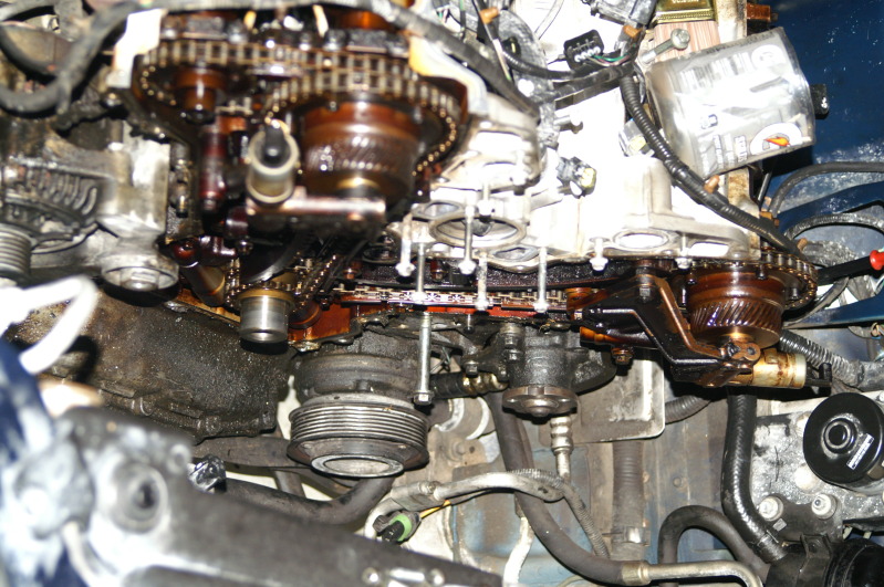

The REALLY good stuff...
Pass side totally out!! But wait, there's more!!! And it gets better!!!

Complete tear down... A little lighter to show more detail...
And a close up of the front...

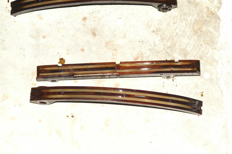

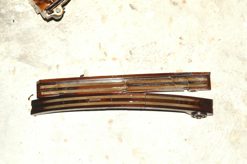

I don't think I have one rail that doesn't have some kind of crack or plastic missing... This poor motor!!

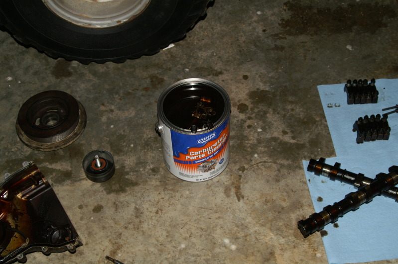

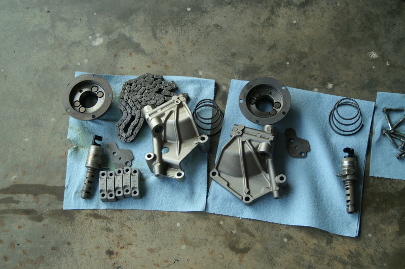

Here are some of the parts I cleaned up today... My carb cleaner is getting saturated... I will go buy a parts cleaner system tomorrow... I needed an upgrade from my old one anyway...

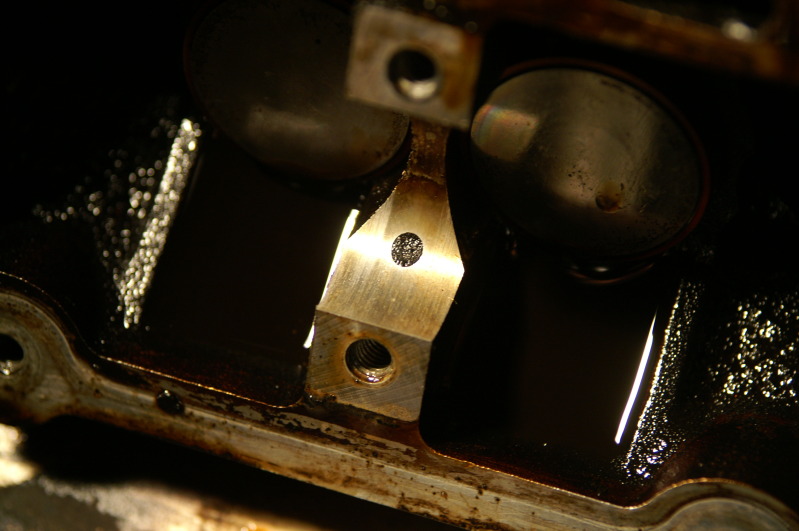

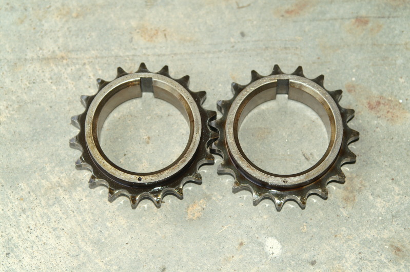

Well, I got bored watching things soak so I pulled the Drivers side head... I first wanted to see how the crank sprockets went together... I already read they are half a tooth off from each other... This is how they do that...
They are technically the same part... BUT if you flip one over, it gives you that half a tooth difference...
Put the two dots together and you have the correct set-up...
and where they go...

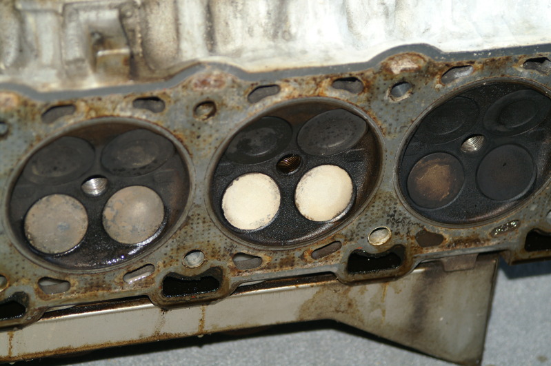

Here is the good and bad news... The gasket was good... The valve seat at the rear of the motor was dislodged... I imagine it is the same way on the pass side...
And here is the mark it made on the piston... It barely even touched it... But the cylinder was dead as a result... Same for the other bank... Essentially, I had a 6 cylinder...

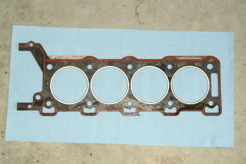

And the good ones...

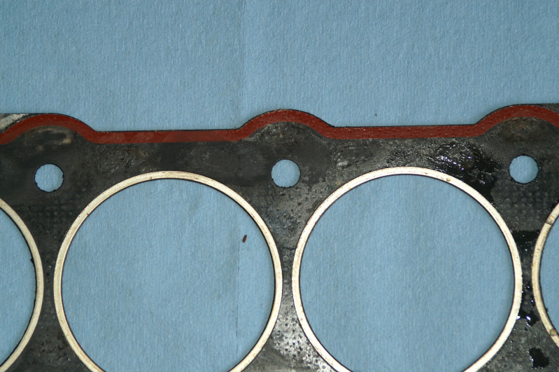

And what you have all been waiting for!!!!!!! The reason why these gaskets fail!! Wait for it!!!!!!! Wait for it!!!!
Well, maybe not... But it sounded good... ****(updated)****

Well everyone, I can't find the picture of the head gasket that I found earlier this week that showed coolant passages... All the pictures I have of the Fel-pro set don't have the coolant passages... I'm pretty sure I saw a head gasket that had the passages... It almost seems pointless not to have them if both the head and block match up... RIGHT?! There is the large rectangular one at the back of the head, but not the smaller ones above and below the cylinders... Maybe that is apart of the design and there is a method to their maddness...
Cheers!!!

As a little tip, I have always fitted 4.2 head gaskets as apposed to the 4.0, the 4.2 are metal and are far less prone to failing like the composite 4.0, it reduces the compression ratio very slightly which is not a bad thing on a 8

Ehum, you mean increase the compression ratio of course, and my best guess for a SC would be about 0.3 points and for a NA about 0.45 if you go for the 4.2 gaskets, but please note these are best guesses.
But I fully agree that the thinner MLS gaskets from the 4.2 engine must be MUCH better, as the head gasket failure rate is extremely low compared to the 4.0 cars with these thicker composite ones.
