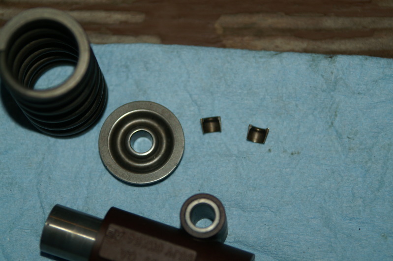

Well, here are the pictures I promised... Sorry so late! Had to make a little detour to the doctors office after Church...
Here are the keepers I told you about... there is only one ridge holding these in where the 4.6L Ford motors have three... I put the primary tensioner in there to use as a size reference...

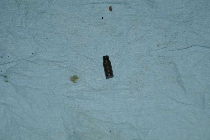

Here is the broken valve cover bolt piece I finally got out of the cylinder head...

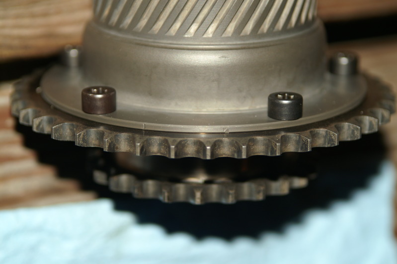

I didn't know this at first, but these are numbered... They were so dirty, I didn't see the numbers... AND you can't get them mixed up... Numbered front to rear; top to bottom... < or > will point towards the front of the car...
And finally, the timing marks I made for the VVT units... It looks like about 2 and a half teeth...

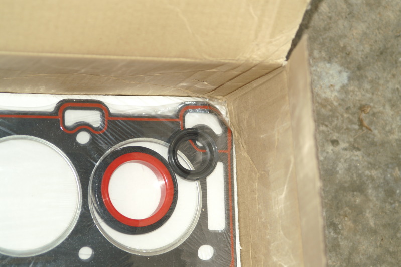

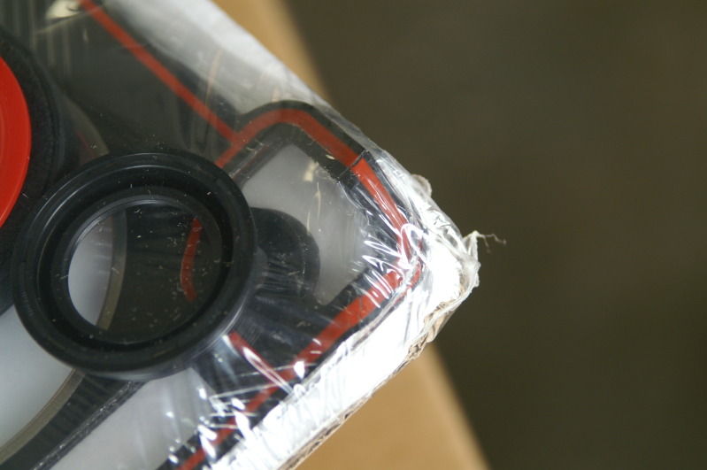

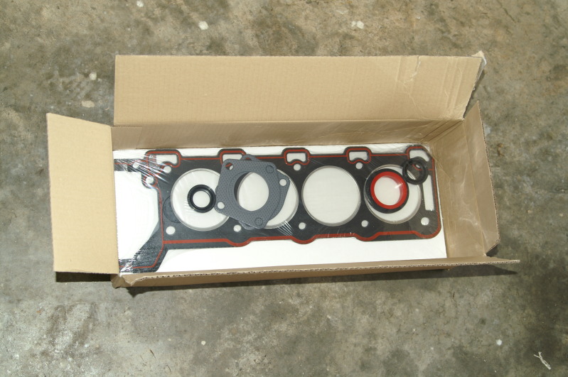

Well, I got the head gasket set from Parts Geek today... Not bad!! 48 hours!! HOWEVER, it is only a good thing if you get to use all the items in the package... I don't know if I should even bother trying to get a refund due to the simple fact I wasn't going to use the head gaskets anyway or get a partial refund for what I paid for... What are your thoughts?
Here are the gaskets still sealed in the clear package...
I doubt anyone would want to use a broken head gasket...

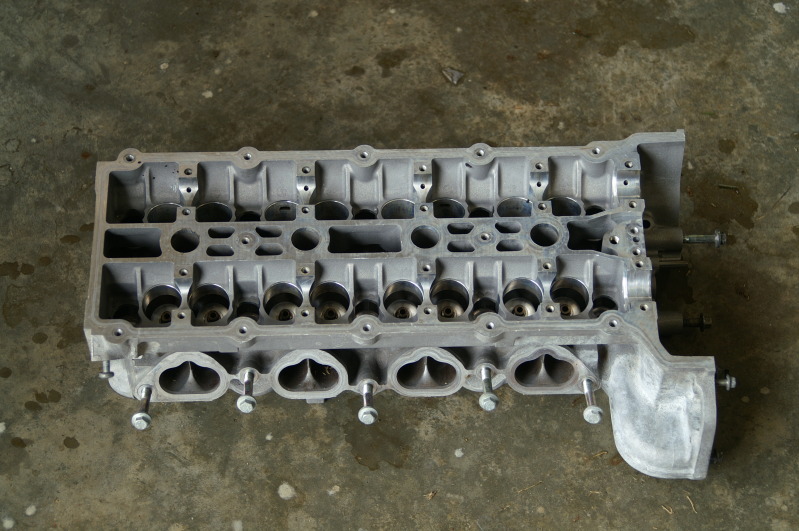

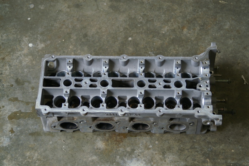

But, here are the cylinder heads all cleaned up...
Now the fun part of waiting for the rest of the parts to come in... 4.2L head gaskets, 3.9L head gasket, tensioners, chains, water pump, power steering pump, shifter assy, engine cover, and misc hardware... The scarf cut VVT assy seals weren't in the kit...
Cheers!!!
